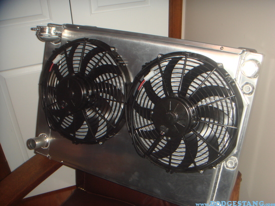

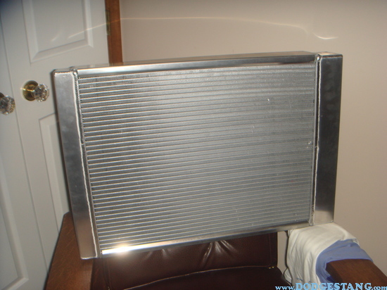

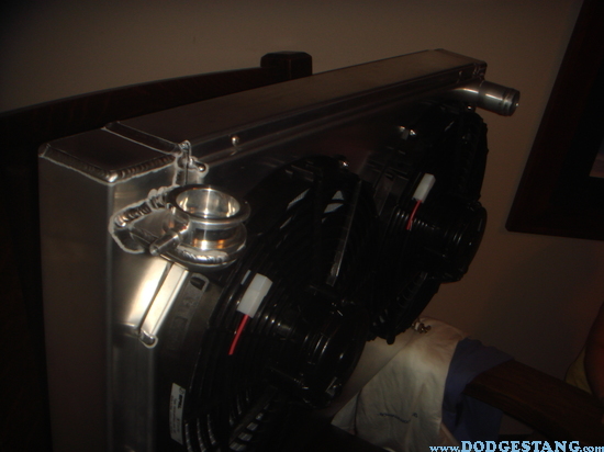

So it took a little while with sad events obviously having their impacts on the process....but it is finally here and Wow....this thing looks awesome. It will be a little work to get it in there....but something tells me the car won't have a 'runs too hot' issue anymore.
Its even got a relocated fill neck so it will slide under the upper radiator support lip without the need to notch it :) Someone much smarter than I added that into the specs....thanks to John for providing them and to Rod for drafting them and then procuring this nice custom setup for me.
Nice looking set up Nick - I think your right, your C won't be a hot head anymore !
Forgot to add - Your a good man Nick. Nothing better than car parts in the household. `
Hey John I've got a question (or two, but one specifically for you)
With this cooler in this size.....71-73 mustang 351c upper and lower radiator hose?
And second....I'm a little sad to see at the price point it didn't come with relays and stuff for the fans, and since I only have 1 in the car now I will need to get more wire harnesses to run these twin fans.....anyone have any good sources?

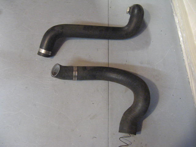

I'm at that point too. I didn't keep or lost the part numbers from the last time I put hoses on the car. These are what I'm going with for now. I did need to do some trimming on them so they will fit the car since the motor sits a little different in the 65 than the 71.
Upper hose -
http://www.ebay.com/itm/Gates-20704-Upp ... ea&vxp=mtr
Lower hose -
http://www.summitracing.com/parts/gtr-60865
Found this set at MU
https://www.mustangsunlimited.com/itemd ... y=EMUSTANG

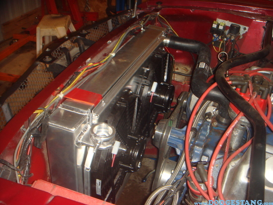

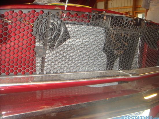

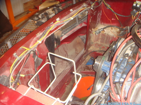

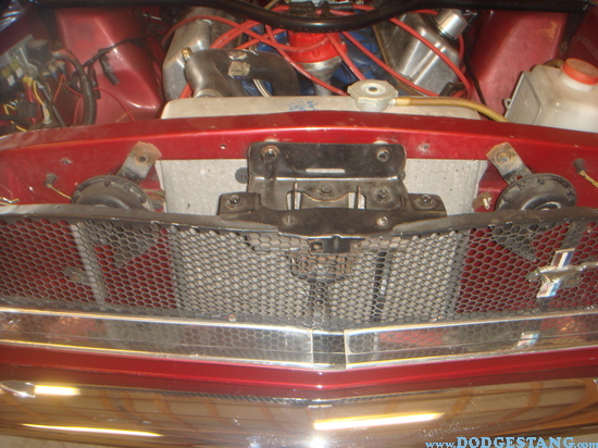

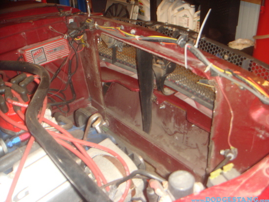

Some of you may know I have had a 410 cleveland stuffed in my stock 65 engine compartment since 2001.
I have been running a fancy Griffen HD cooling setup that fit in the stock location since about 2003 with a spal 16 puller fan and have had mediocre results.
Well today I pulled the trigger and did something that makes it a little harder to simply unbolt some stuff and turn it back to stock ;)
I took out the griffen setup

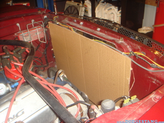

I made a template....
I made sure to measure once and cut twice....
And whalla...65 radiator indent bubble gone....and

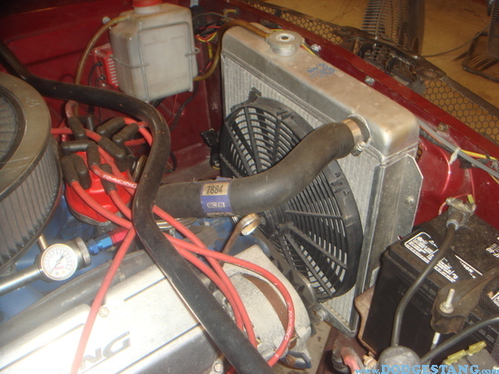

25 inch monster installed
Things left to do after today
1. Fab up second upper mount. I did the lower mount and it turned out great and the left upper is 'ok'.
2. Re-wire 2 wires that I had to cut out from the lower end of the radiator support.
3. Fab up new transmission lines. The radiator has a cooler, but it doesn't like the flared lines I have....it must need AN fittings or something so I have to call the manufacture and find out....or maybe Rod can tell me ;)
4. Finish modifying the battery tray and reinstall
5. Find an 8.5 inch wide battery (probably the unobtainiam task)
Overall...I am really happy with the install. Slides right between the frames with paper thickness to spare on each side and I was able to use 71 hoses with just a little tweaking from a razor blade.
