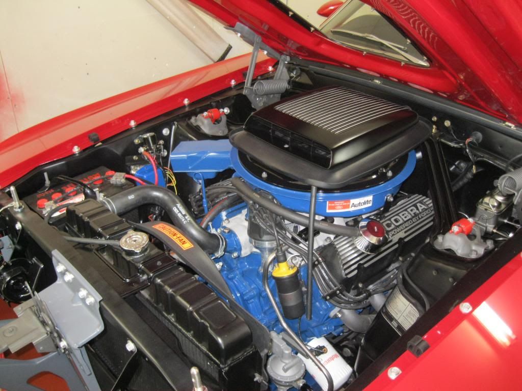

Here's a couple shots during the build. Yes, I painted the box.
Thanks for the pics. Big help. I like the fact that you painted the dist, coil and box. The only thing that I do not like about MSD is the red and gold. It is starting to look like a rainbow under the hood
