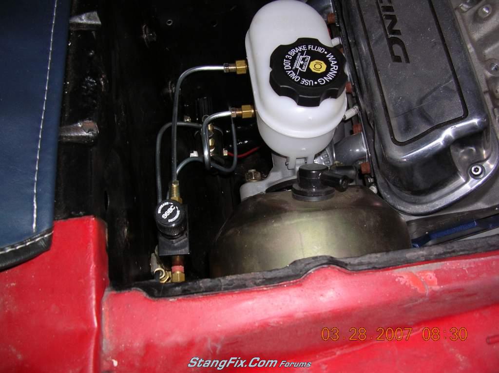

Installation adjustable valve
My hands are really hurting from bending all the brake lines! The tool from Eastwood saved the day, but still was rough on my hands! Now I just need to install the rear axle, but waiting for my geek mechanic to put the axle bearing on! He's had my axles for almost 4 weeks! I'm not finished with the installation, but the most difficult part is over.
My engine compartment is getting closer for the motor! :pep This installation was definitey a challenge. I made a little bracket to hold the valve and it worked well. Well, I'm going to put my hands in some ice water! As usual, thanks for all the help and advice! :bow
dne'
Dne,
Looks really nice, I would however suggest pulling that one line off the aprom a little, it'll end up tearing into the paint. It may not even be touching, but it looks pretty darn close.
a little more work left
Thanks, yes, I'll be moving that line away from the apron. I saw it, I just had enough for this evening! lol There's still more work to be done here. Just tiding up I guess, fastening the lines to the firewall, etc..
