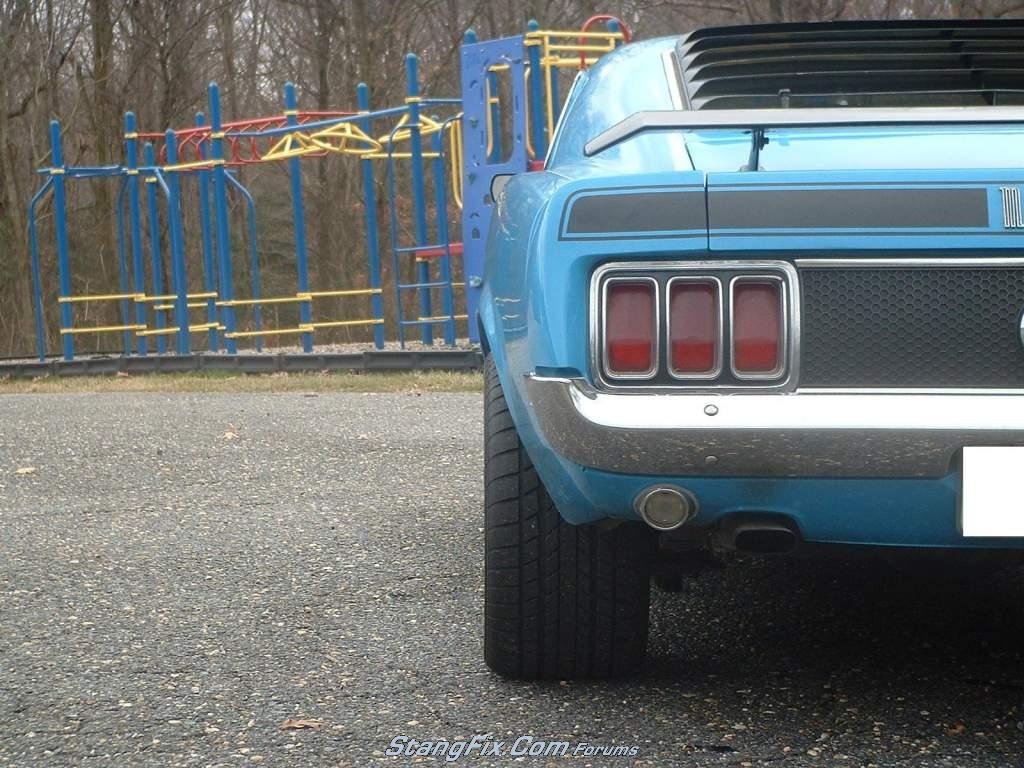

I ran across this picture of Grabber70's rear tires.
Taking a ruler to my computer screen, his outer tire edge would be flush with the quarter panel above the wheel lip. I don't think it would tuck into the wheel houses, which with his stance as it is the max suspension travel may not go too much into the wheelhouses.
The wheelrite tool arrives in the mail today and hope to get some measurements this weekend. I'll let you know what I find out.

As long as there's no desire to keep the tires/wheels within the wheelwells.... you can go pretty wide.... just as you've pictured. Neither your front nor your rear tires will fit into your wheelwells. Lowering the vehicle is out of the question with those wheels... you'll actually have to "raise" the body to prevent tire/body panel damage.

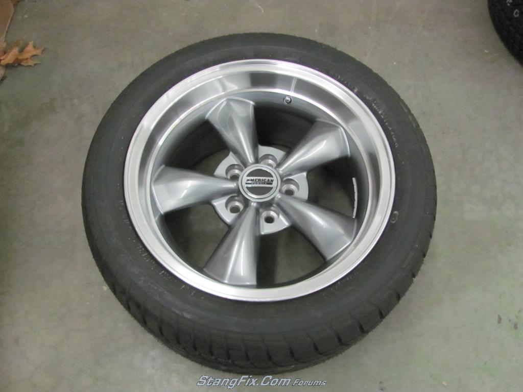

I finally bit the bullet and ordered a set of 17x8/10.5 anthracite bullitt rims last friday. The 17x8 are on backorder for a week or two. I'll start a new thread when I go to install them.

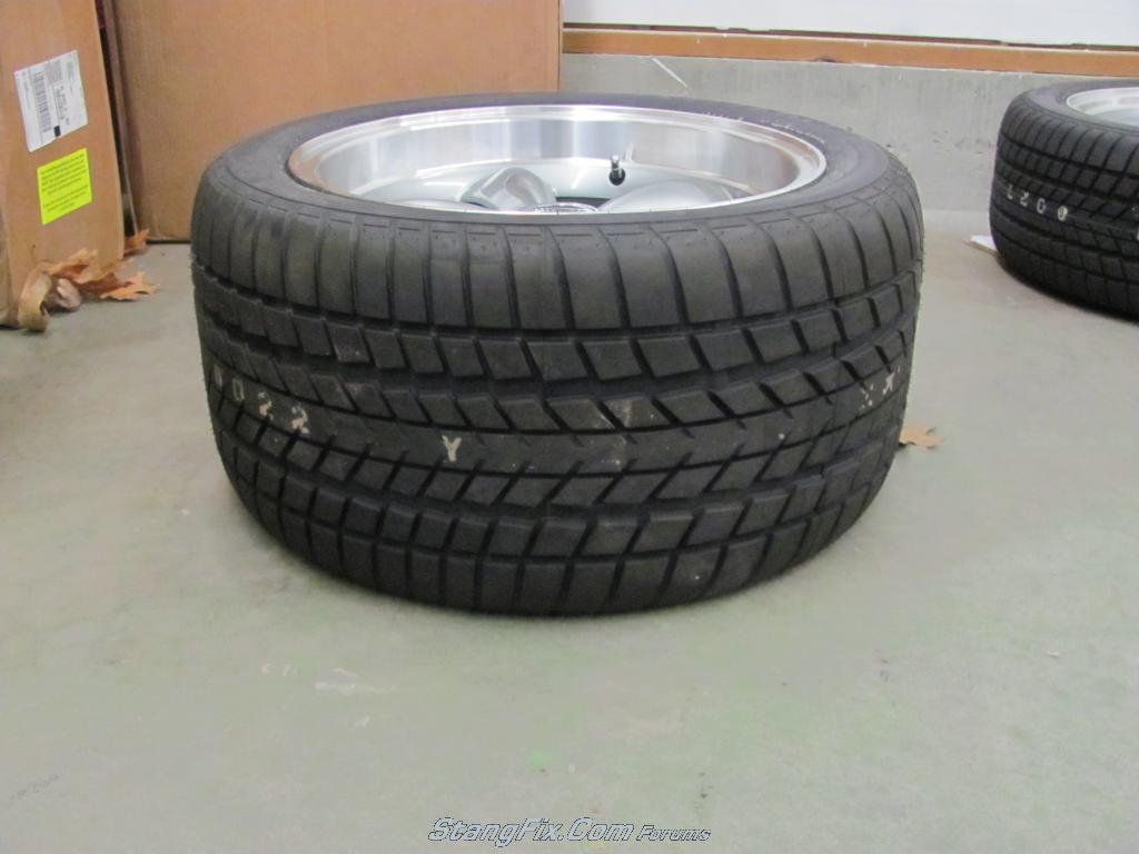

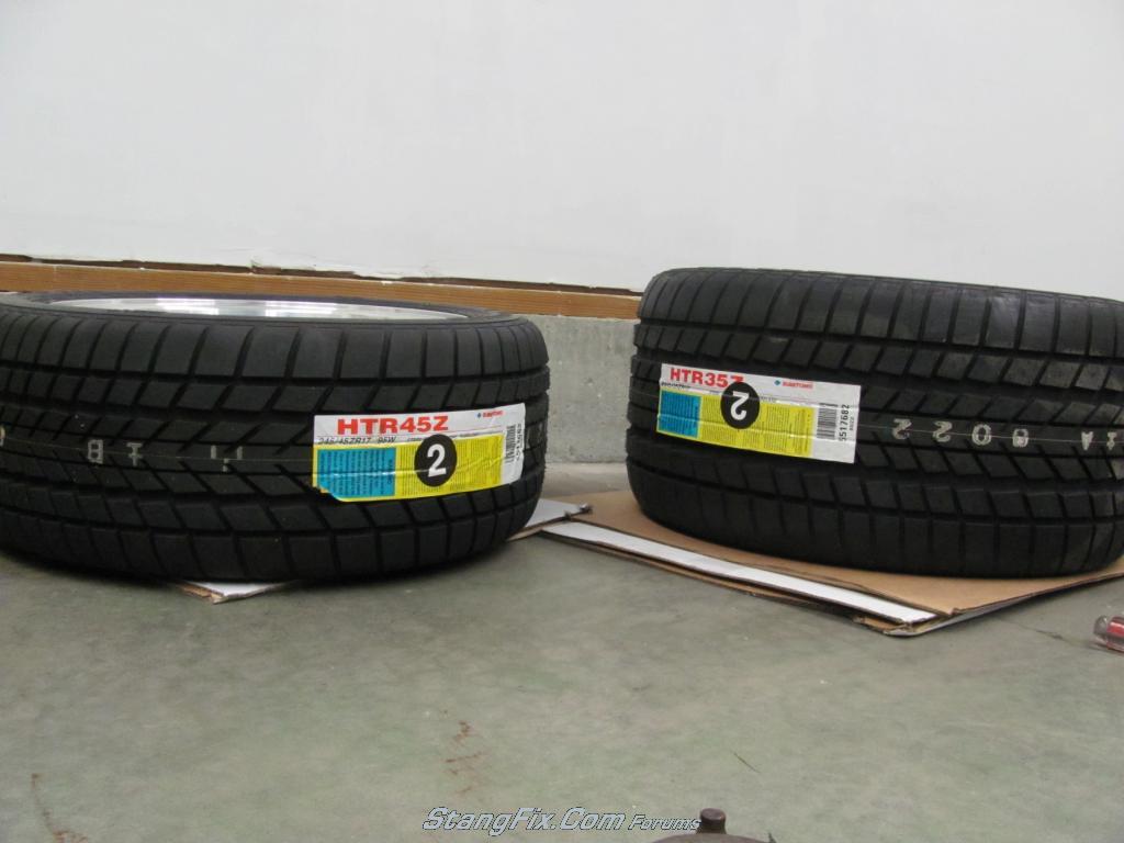

Same setup as Grabber. 17x8 245/45 fronts and 17x10.5 315/35 rears. Here is a pic of the 245 next to the 315
and here what they replaced, 14" Cragar rims with 205/14 tires.
The extra 3" rim diameter is pretty pronounced next to each other.
And here is the puny 205 tires next to the 315 that will be going in its place
Haven't had a chance to install them. My brake calipers and spindles were a mess thanks to a leaky brake hose awhile back. Figured I'd better take them all off and give them a fresh coat of paint. Probably mid this week before I get them installed. I'll start a new thread when its all done
Wow! Gotto love em! Sumitomo's, best bang for the buck out there when you are gonna run fattys larger than 295's. Same thing I have on the Cuda. Are those 17's going to be close on your upper control arms?

I was actually trying to see what else was out there besides the Sumis in 315s, but amazingly there were only a couple manufacturers that make this size and they were all about double the price of Sumi's (Goodyear Eagles for example).
