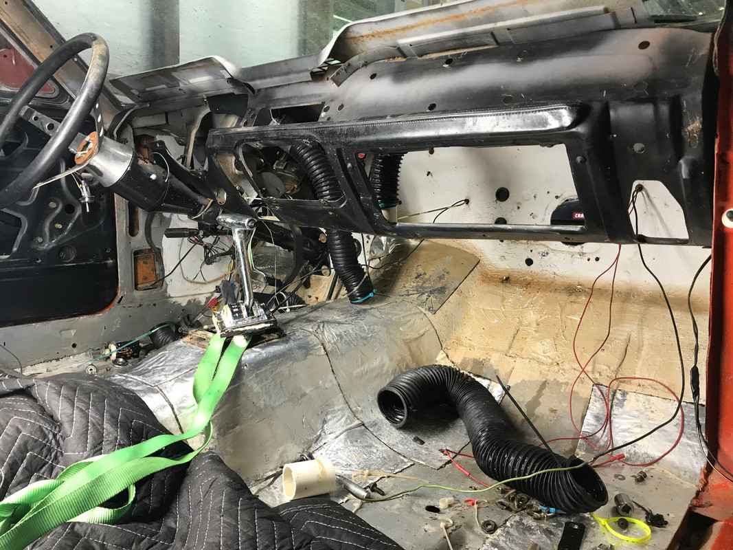

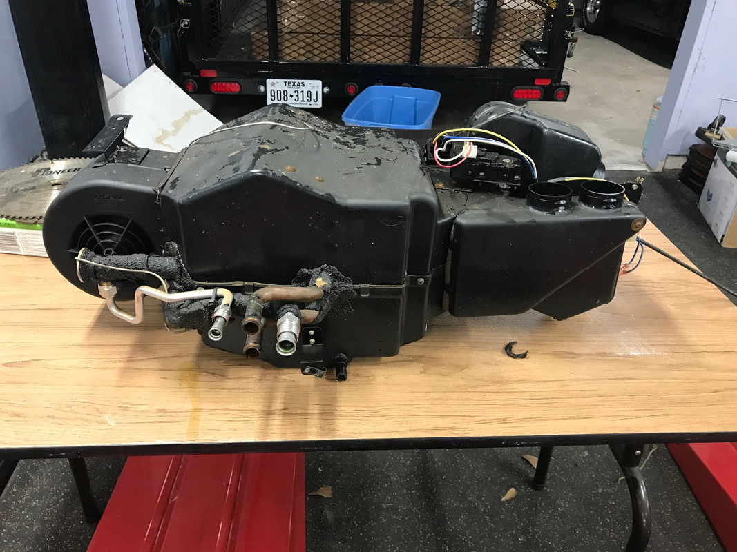

    Wowzers, had a little time today, oh, wrote Randy(midlife) regarding wiring and he's going to set me up when the time is right, gee, he had the date when he checked out the under the dash wiring in '08!! Incredible!
    Speaking/writing of wiring, wrestled the evaporator case and under the dash wiring out~ ugh, Gosh that was a pain, kidding, wasn't that bad.

    Does the fan still work in that unit?

    Hi John! I didn't try anything on the Mustang say by turning on the ignition, I just figured everything was/is kaput. I was,I am hoping to make the ac system work by replacing the blower motor, take the evaporator case apart, but I don't know if parts are even available for it(actuator switch/blower motor). I know a replacement evaporator system is about 700, the entire AC system is about 1400.oo, but I don't need the entire system( condensor, compressor, etc). I'd replace the blower motor if available, it was testy to remove. Just trying to save money where I can;)
