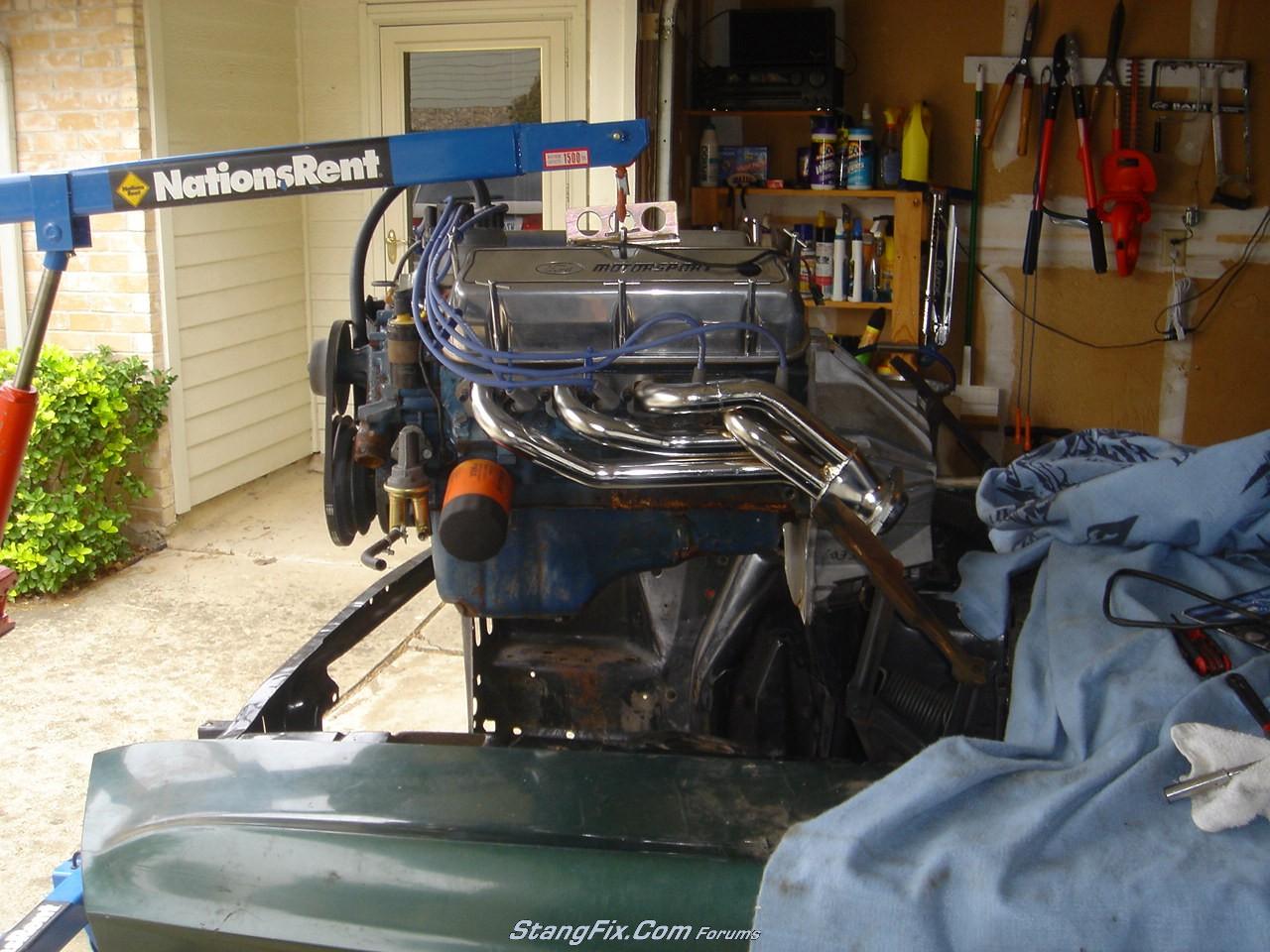

From your engine hoist photo.... you're going to need to run that lift beam extension all of the way out to the 1000 pound position (the last pin hole).
Also, your 8' garage ceiling should be fine.

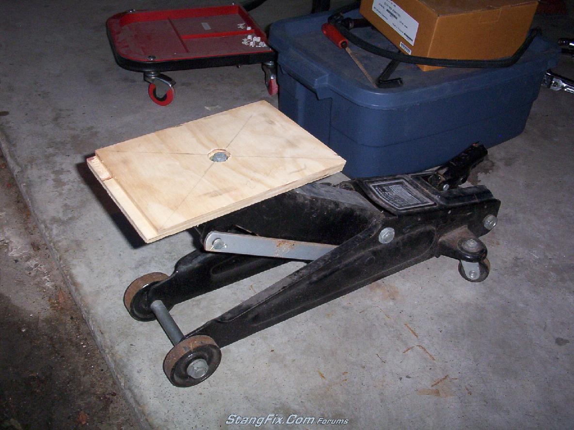

I made my own tranny jack by simply bolting a piece of plywood to my regular floor jack. You just have to pull the pin and remove the little round cup and bolt it on.
