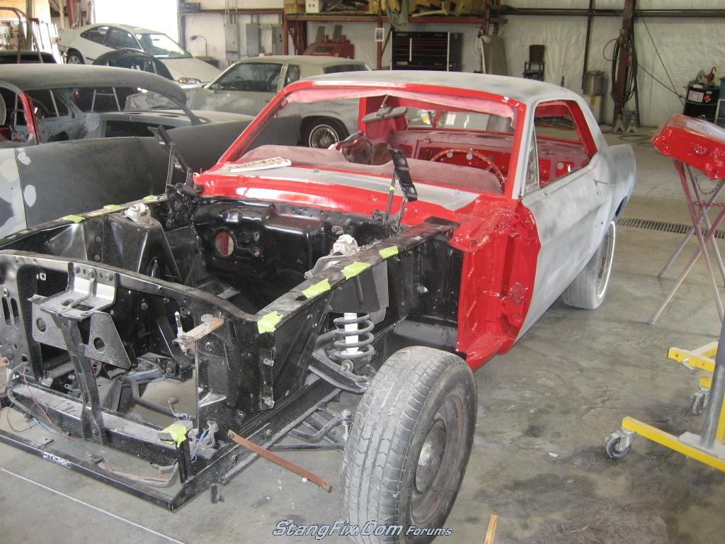

Now I'm kind of depressed about the front height. My husband came out and put all his 245lbs on the front and barely moved it downward! is there a chance that the springs are for big block? or what can I do? I'm an expert at removing/installing springs! lol

Yep....looks a bit high........wait until allweight is on the car and you have moved the car to allow the wheels to reposition properly.

After you have all the weight on the car (looks like you're almost there), just cut the coils down a bit.
Looking at your current height, I'd probably start with at least 1/2 a coil on your first cut. If that's not enough, then cut 1/4 coil each additional cut until you have the ride height you want. Since this is a free modification, you might as well try it before going out and buying new springs... or a big block engine! :yikes
Along with the 1" lowered a-arm, I have 1" lowering springs on my car, and I still had to cut 3/4 of a coil to get the ride height I wanted.
