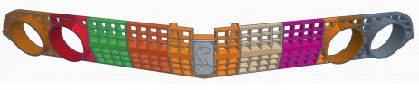

Im getting wild with my 3D Printer and Designs :) Ive already had to redesign it a couple times as you see the below print, its a bit over engineered so ive thnned the sections out a bit
Got half the prototype printed as as usual, alterations are needed. Bezels need moved over, Ends trimmed down, mounting pushed back a bit more
376059839_122123735390006641_5361231911395379361_n.jpg376059839_122123735390006641_5361231911395379361_n.jpg
Impressive. That , I can't do . Are you gonna coat it or use it as a mold or what ?
Right now the goal is to get it fit then print it out in PETG and piece it together. I will definitely consider making a mold for it as a lot of people seem very interested in the Torino world
