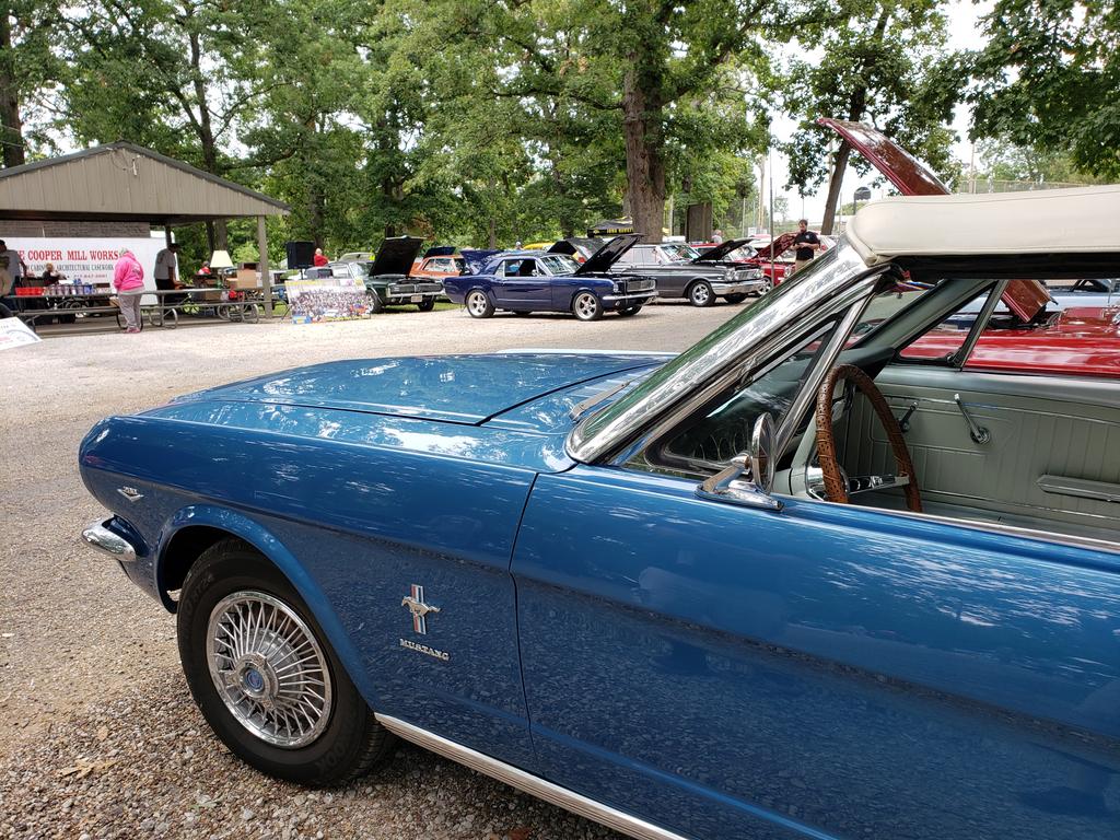

Right after pulling it out of the barn...

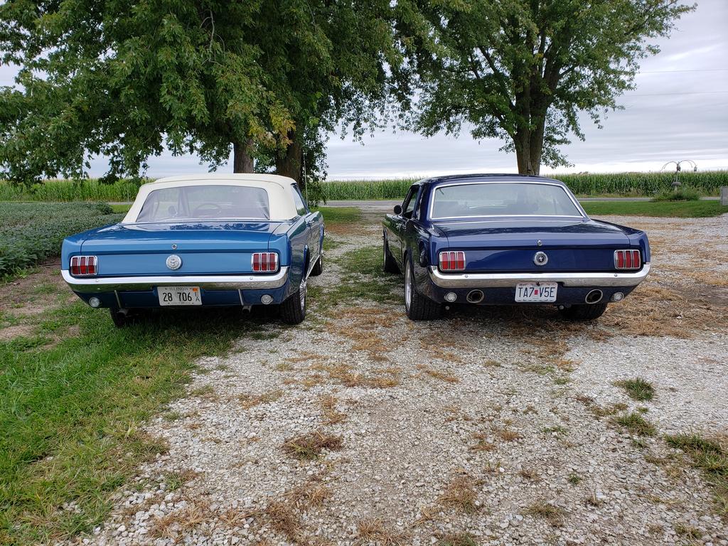

Jeffrey was driving my car...

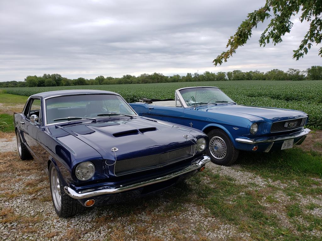

Playtime the night before :-D
