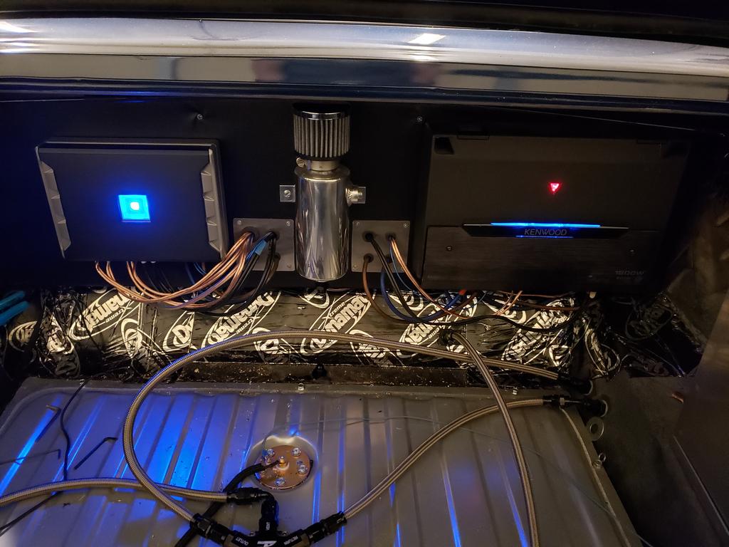

I couldnt sleep this morning so I got up stupid early and sorted out the trunk area as well as got amps, sub, and speakers hooked up. I did a quick test...sounds FANTASTIC!
