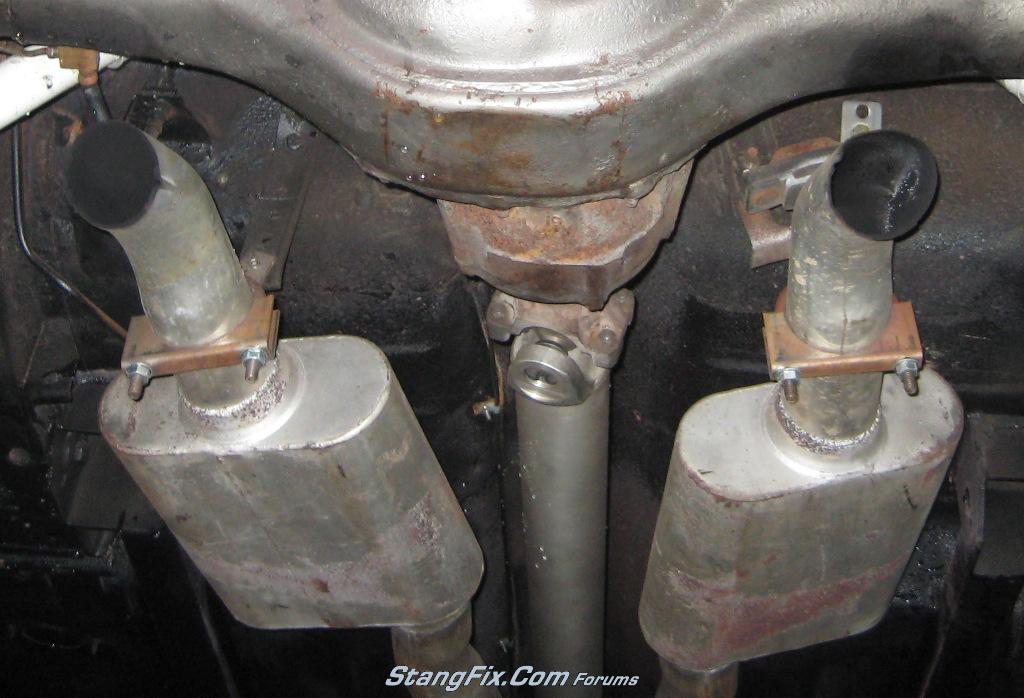

had new Magnaflow SS muffelers replace the Flowmasters too.
photodisplay.php
now I can go with PS too since I have much more clearance
