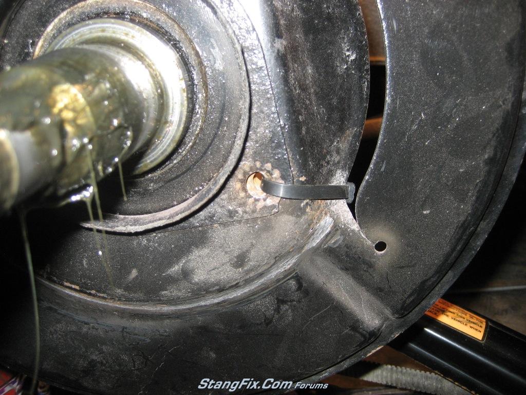

Driving from Barber to Homewood during the Mustang 45th, I lost a couple bolts from the left brake dust sheild. The sheild rubbed against the rotor and made a horrible grinding noise. I couldn't fix it on the side of the road so we continued to Homewood. I didn't have a lot of tools with me to pull the caliper and rotor so I billy rigged it with a cable tie.
When I got it home I fixed it right.

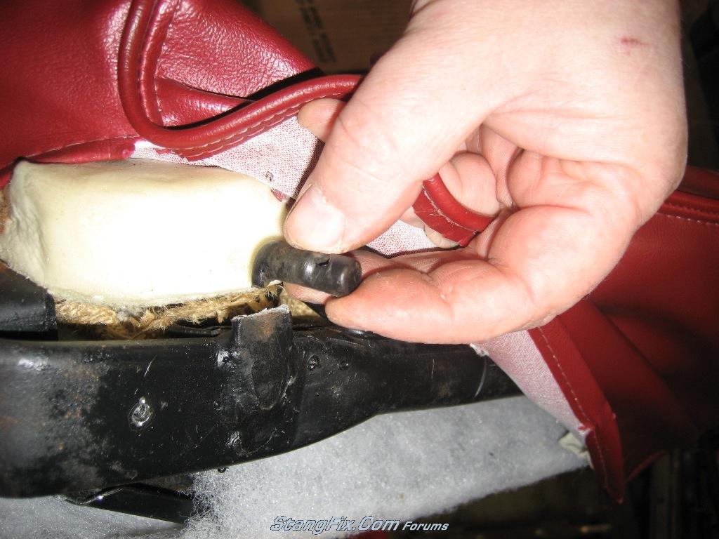

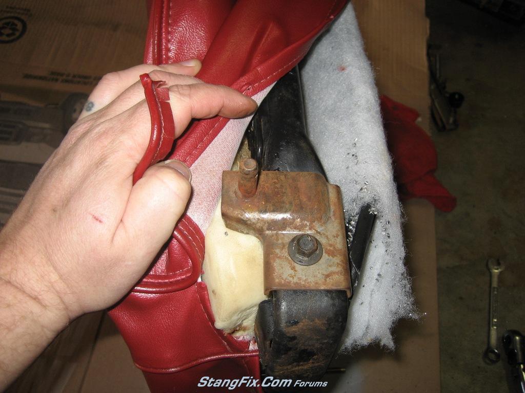

one day after picking up my son from school, my lard butt must have been too much for the 40 year old seats and it broke going up my street.
I was decided I would have to weld it back together, but I had a set of seats from a parts car laying around. I thought maybe it would be better to swap the seat cover. When I stripped it down I found that it had been repaired. Appearantly Ford had a fix for this problem. A seat repair pin D7ZZ-69618-C47A. I just had to drill a hole and use the self tapping screw.

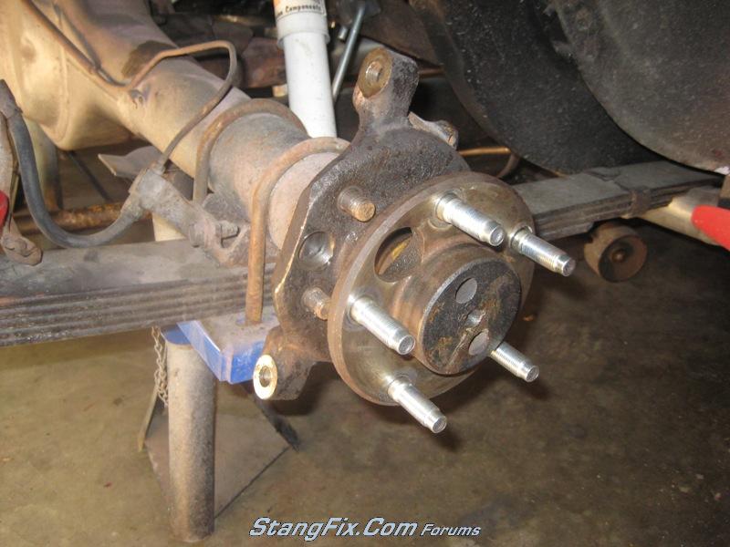

at one point I even broke some of the rear studs on the right rear.

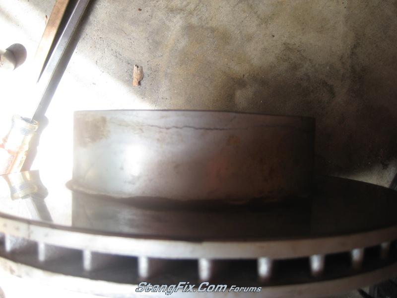

I also cracked the rotor in the process.
In this photo you can see a hole in the caliper bracket, I had to drill this in order to get the new studs in. I could have had the bearing pressed off, replaced the studs and then have it pressed back on but I didn't want to do all that. So I put the axle in my drill press and started drilling. The drill went pretty far thru but then chipped. I reground it and began again, and it chipped again. Then I used a $40 step drill which proceeded to snap off. I had to finish it with a dremmel. What a PIA!

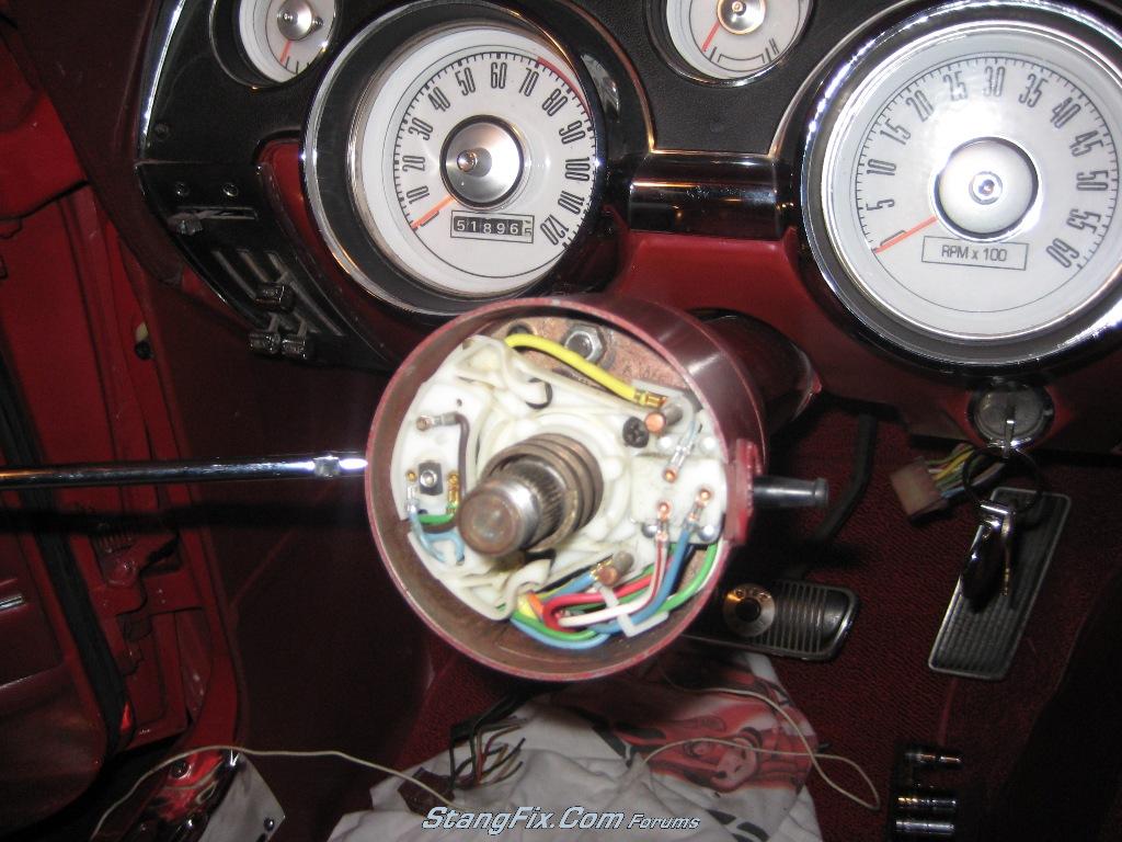

I also had this nagging intermitten blinking of the brake lights. I burned up the original turn signal switch before I figured it out. I had a 68 parts car that a new NOS switch. I used the TS switch from it to replace my fried original. The plug ends are different 67 to 68, but everything else was the same.

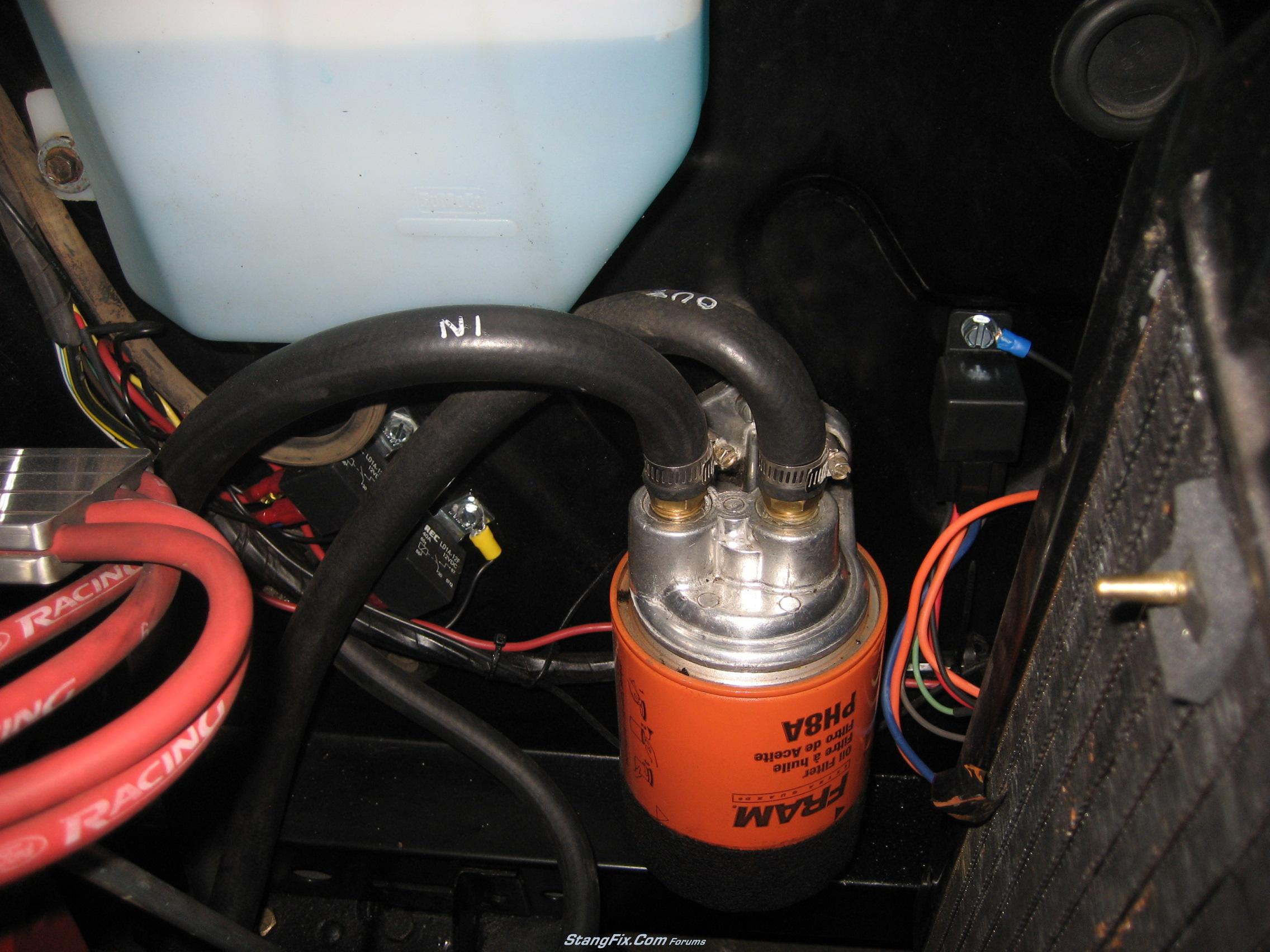

I added relays to the headlights thinking that the halogen bulbs were overloading the headlight switch.
I changed the dimmer switch and headlight switch, still had the problem.
It turned out that the added bulbs for the Cougar tail lights were the source of my problem. I added relays to the brake/TS lights and problem was solved.
What in the world is this greasy stuff on your axle while repairing your brake shield? Ewwww!
I sneezed.
I think you called it.....grease from the front spindle/bearings.

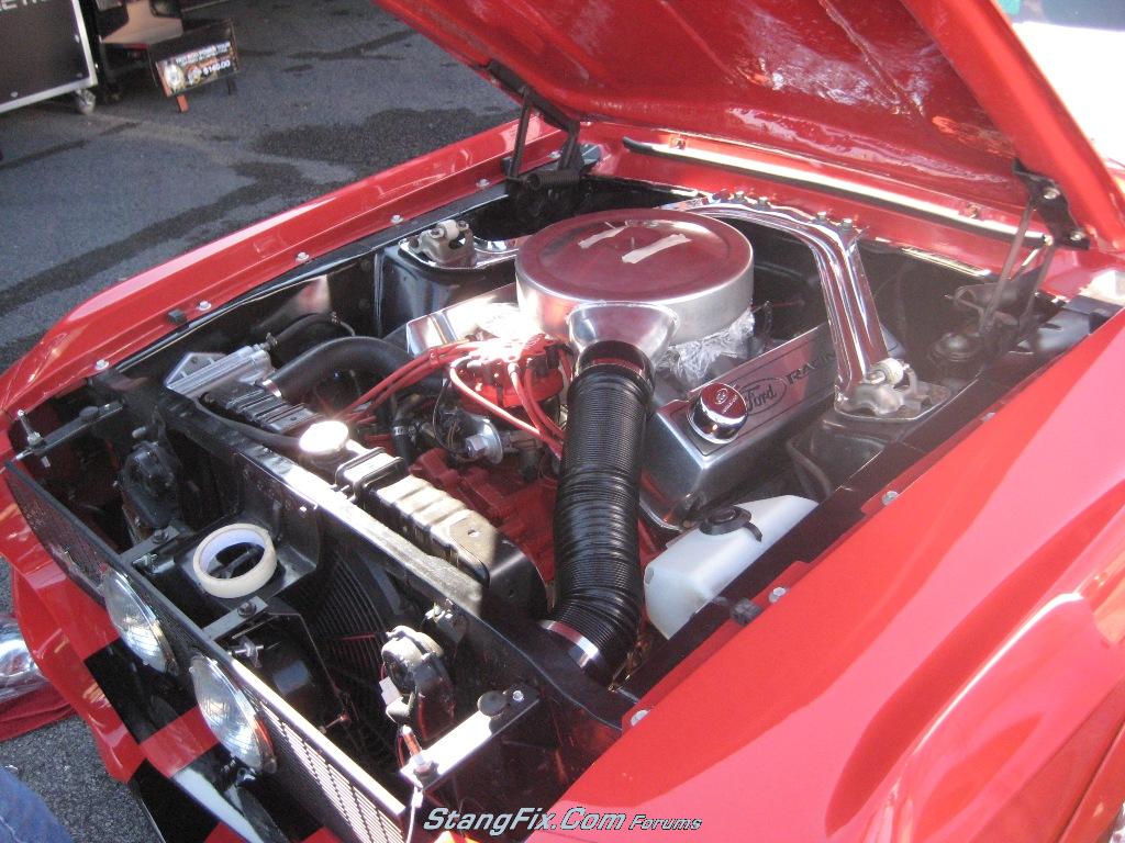

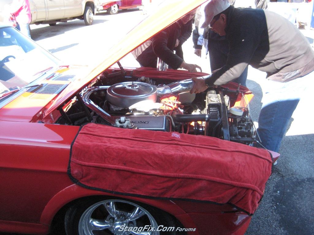

I just sold my old Tubular Automotive headers so I had a little spending money for the Stang. I wanted a cold air intake but with the low profile Eleanor hood and the big 385 series Big Block I didn't think I had room for anything. I had seen the Spectre trailer at the Good Guys show in Nashville back in July but didn't have the funds for anything. The Spectre crew had a vendor area set-up again at Beach bend with their rig and I stopped to talk with them. They said I could take some stuff to see if it would fit or bring the car over to their site. I brought it over and they went to work.
Option #1 - low profile air box & flex hose ~$150
Option # 2 - they temporarily hooked up some various bends and straight peices to mock up the tube that will be welded and polished ~ $350
The final product will be all welded and polished, they were great and spent a lot of time trying differnt things. I was impressed with the way they were willing to help!
