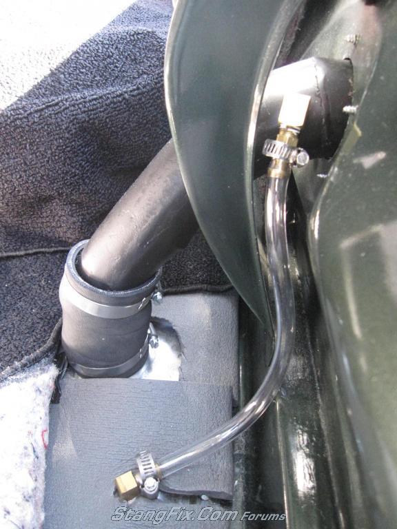

Just an idea, but if you added a vent hose just below the flapper would that not help prevent it from blowing back? Course, I have seen a many different car have gas blow back out when being filled up, even my own.
My current filler (which I haven't advertised) actually has a 7/8's tube inside the filler that runs the entire length of the neck and into the tank. It's held in place with the same "washer" type flat stock near the opening. I thought this would let the air vent while gas flows in and I think it works fine. It does however, have issues with the "auto-shut-off" no working. I don't think all nozzles are the same. They are supposed to work off of a pressure sensor and shut-off when the sense an increase in the pressure. So far my design is just not creating or allowing the pressure to build like a modern OEM filler
Very happy with my vent hose setup.
do you ever get any problems with the nozzle not shutting off? Can you put the nozzle in on full blast and let it go with no hands?

I assume you are referring to the tank's inlet snout? I don't know if having a line running down the inside of the filler neck would provide enough ability for the air to escape. Maybe that's why I ran an external vent tube from the top of the tank up to towards the top of the filler neck.
But it has always been my opinion that due to the right angle of the stock 67/68/69/70 filler neck the end of the pump's nozzle is forced to blast against the backside of the neck, causing more potential backsplash. Thus why I installed a 65/66 neck which I had to cut and modify the tube of the neck to make it more of a straight shot down to the tank's inlet snout.
To me, both of the above mod's has made my filling of gas so much easier.
