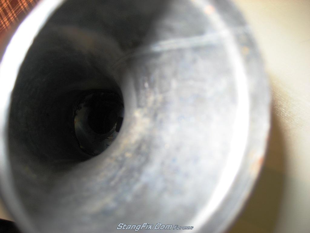

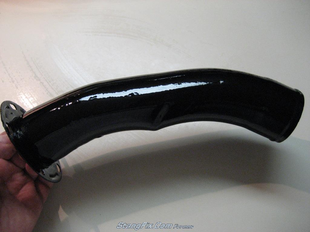

Here is Pete's, first pic from inlet side with drain hole at bottom. 2nd pic is tank side and you can barely see the deflector that should prevent fuel from going back thru the drain hole. Last pic is the side view, you'll notice it's quite a bit different than a 67/68 shape which is pretty much an elbow.

Finally got around to installing the modified filler neck. Naturally, it went in with no problems.
Then, today I went to fill the car to see how it functioned. After checking the fit of the nozzle, I felt it might not work. It seemed that the modification kept the nozzle about 1-1.5 inches further out of the neck than I liked. In the past, the nozzle fit up to the rubber splash guard. So, I placed a towel below the neck to catch anything that might happen. I then pumped some gas slow. All looked well. Then, I went to full flow.....I put in 10 gallons like that. The auto shut off worked as it should and the amount is real close to what I figured I needed since my gauge is screwed. Upon shut off, I removed the nozzle and saw a bit of dampness about 1" down the neck and the fuel nozzle had dampness to match that position. No fuel escaped the neck at all.
On the way to the RV, I did a couple hard accelerations and then checked the inside of the cap for dampness. I could see dampness in the neck but no fuel seemed to reach the cap as it was still dry. Any fuel that got past the modification had drained back down thru the small drain hole.
All in all, I would say it works good. I will continue to monitor it and report if there are any problems.
