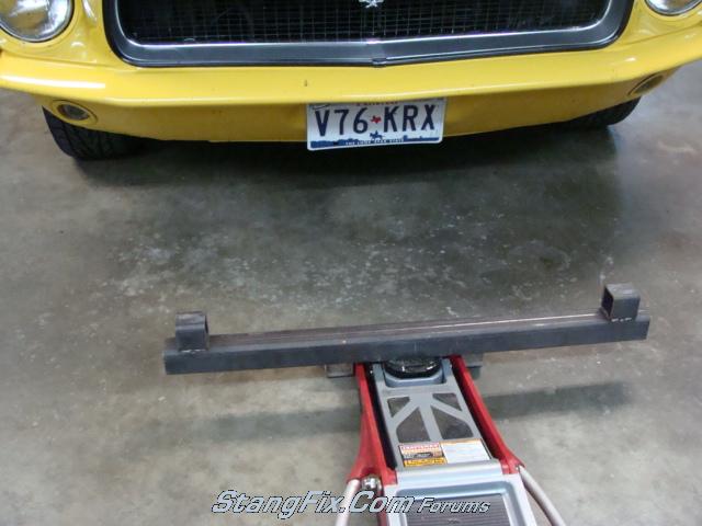

My Unisteer R&P replaces the factory crossmember. I found that I can jack the car up with it, but you have to be very precise about it. It slipped once and put a nice crease in my Canton pan.
So, I made a "bridge" that spans from one frame rail to the other just behind where the valance bolts up. I made it out of 2" square tubing with a short piece of 2" tubing on top of that at each end so that the bridge doesn't hit the strut rod bracket thingies. I marked the center of this bridge so that I know where to put the jack, and I locate the feet of the bridge right behind the valance. I can jack the car up just fine with this, but not as high as you can with a factory crossmember.
I do miss my factory crossmember.
"68EFIvert" said:
Do you have a picture of your "bridge"? That sounds like something I could use! :ecit
Here ya go. Please overlook the bugs on the nose...
I considered adding ears so that I could somehow bolt it to the car for improved safety, but I ran out of patience for all that.

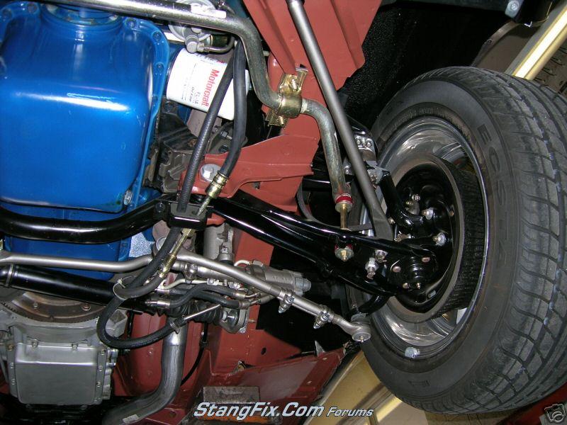

Man that looks like a manhole grabber. AFAIK the oil pan should be lower than the sway bar. Below is a pic of the underside of a car, although the angle doesn't help give it much perspective. The angle of the LCAs prove the weight of the car is on the wheels.

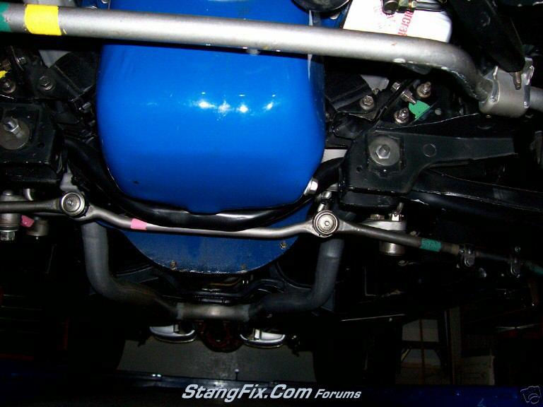

And another with aftermarket sway bar:
My swaybar actually hit & scraped going up a very steep concrete drive into a parking lot once. I hit the ramp entry going a little faster than I should have, but I was making a left turn through 2 lanes with oncoming traffic, so I wasn't able to just putz it up the ramp like I normally would have.
FWIW, my front bar sits about 1 1/2" above the bottom of the oil pan.
