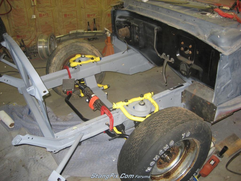

"daveSanborn" said:Johnny,
Great days worth of work!
How were you able to determine the placement of the "cut to fit" engine mounts? With my kit I had to hang the engine into position and mock up the mounts before cutting them and welding them into position. Did R&C have the mounts already welded onto the crossmember for you?
Good news: The welds look spectacular.
Bad news: The front sway bar brackets are welded on backwards. The "L" should face inboard, not outboard. They will not work in their current position and will have to be cut off and re-done. To prove this to yourself, hold the kit provided sway bar up to the "L" brackets and you'll see what I'm talking about.
My kit install is pictured below..... notice the sway bar mounts.
Have fun in Dublin!
it's funny because I thought the same thing..I followed the supplied instructions to the T and afterwards I was looking at some pictures I had on my computer and I have some pics of your suspension setup. Needless to say I let a few four letter words go but then I double and triple checked the instructions and they are correct..maybe they change around for the big block application...I'll call Willie tomorrow to double check.
And yea, R&C have a jig and the put the motor mounts on in the factory..saves me a bunch of hassle.
