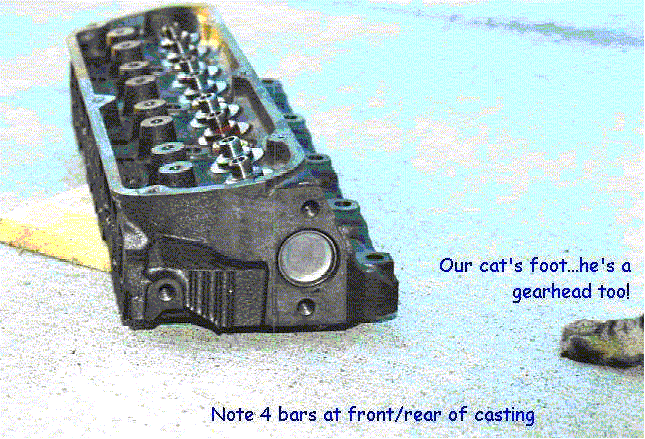

	"Horseplay" said:It looks like those are GT 40 heads. There should be three vertical bars on the front of the head. The "real" casting number is on the underside of the head and you would need to remove the head from the block to see it. You can a date code off the head by pulling a valve cover.
