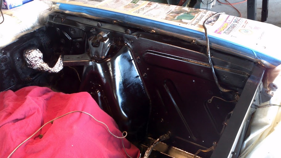

Ooops...sorry. Here's the pics of my new setup:
