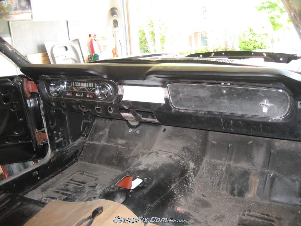

Since I R&R'd the metal dash, I figured I better check the fit of the dash pad, gauges, and glove box door. Fortunately for me, they all fit well.

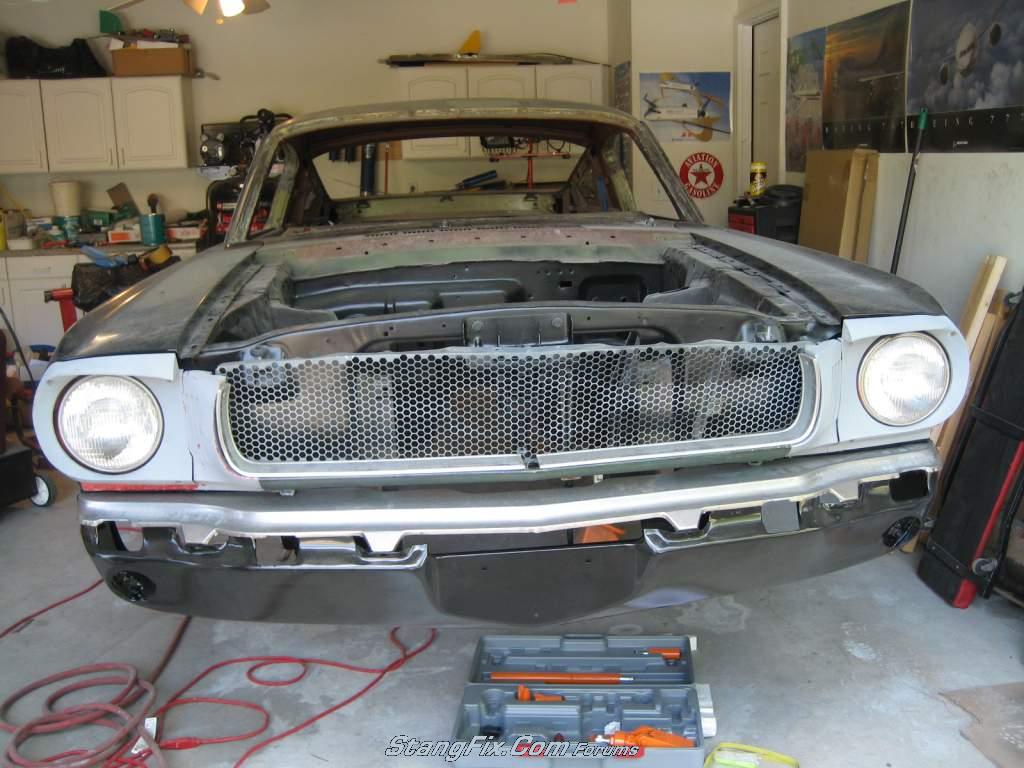

I stuck the grille in too, just so it would at least look like a Mustang. I'll probably replace the grille, as it's pretty beat up.

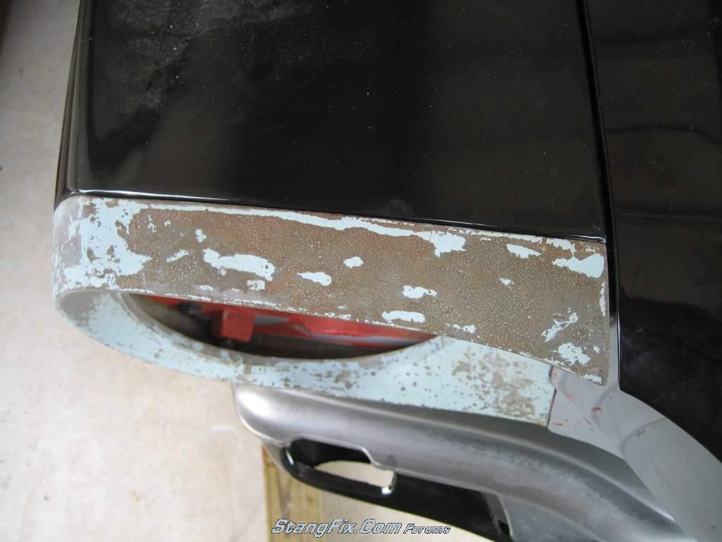

Okay, so the vertical screw idea worked wonderfully. I have the headlight door flush with the fender, and am very pleased with that.
However, then I decided to put the hood on to make sure everything lined up, and WTF is this???? I'm at a total loss here. With the headlight door flush with the fender on the side and top, there is no way I can adjust it to fit the hood line, or even remotely close. I'm going to try to find some other headlight doors to try, but again, WTF???
Re: '65 Fastback Build--Update 4/23/10
Okay, I couldn't stand it, so I had to go back out to the garage. The passenger side headlight door is bent, which is actually a relief. I went on to the driver side which wasn't as bad, and with a little more massaging I got it close. However, it seems like I'll need to pull my hood forward or fender back as the front is now off. It never ends!

I was able to get another pair of headlight doors from a fellow Mustanger, and I have the fit much better. The passenger side is dang close to perfect. The driver side is close, but will need a bit of tweaking. Fortunately, I kinda know the direction to go, as I've been working on this issue for what seems like eternity. I did have to widen the cowl to hood gap slightly to align the hood to the headlight doors, but it is still plenty acceptable. Pics, of course:

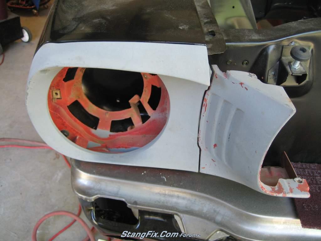

While shopping for places to paint my '65, I found a really great place. Unfortunately they wanted double my budget to finish the car. However, the bodyman/painter there called me and agreed to work at my house on the weekends for half the price his shop wanted. Once the car is ready for paint, he will paint it at his shop, but all other work takes place in my garage. He has now worked for two Saturdays in a row (9-5) and I'm more than pleased with his work and progress. He finished the hood and roof, the roof being the biggest PITA. I work every weekend, so it's fun to come home and see what he has done. Couple pics attached:
