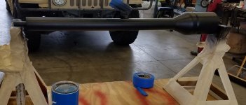

    I did get the column primed and painted. I used Eastwood's 2K epoxy primer and rat rod satin black. That's the plan for entire interior, and the aluminum dash and door panels from the 67 deluxe interior. I need to finish a few small things, but the column is mounted and fits great with the billet bracket.
