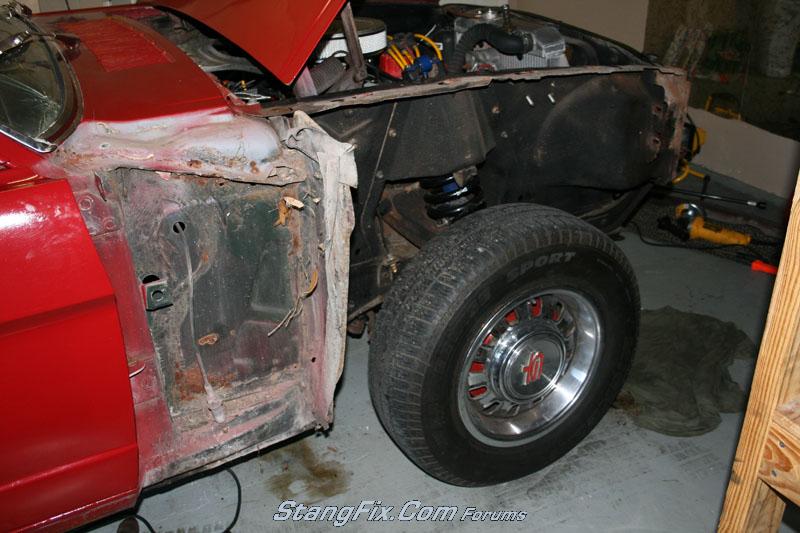

After many curse words finally got all the bolts out. Had to run to Lowes to pick up a torch but money well spent. Got those bolts out with no problem.
Kind of nasty behind the the fender. :eek
What was this? Some kind of sealer/insulation? It feels like cloth and very brittle.

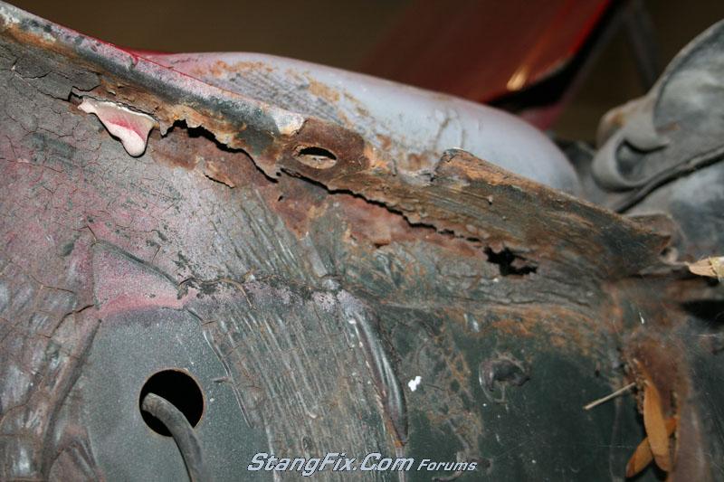

Found some rust holes at the top, near the cowl, as well as some lovely cobwebs and dead bugs.
More rust. Would this be easy to grind off and use some rust treatment/prevention? I really don't want to have to replace that whole piece.

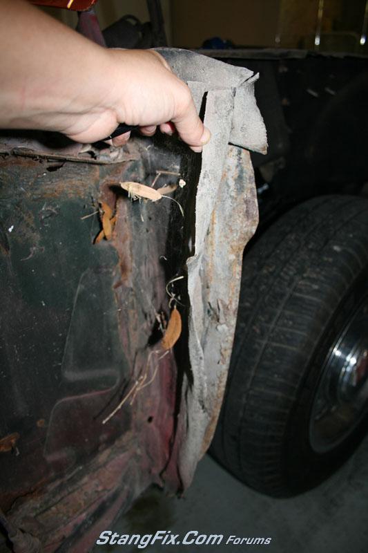

Backside of the fender... yes the rocker panel is still attached. Screw wouldn't come out so I said heck with it.
There seems to be a square area (bottom right on the fender) that was patched. Not welded, but clearly not the same piece of metal. Maybe it was glued on with body adhesive or something.

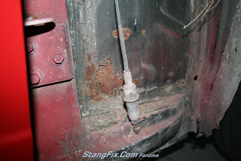

Whole backside of the fender. Nasty and rusted.

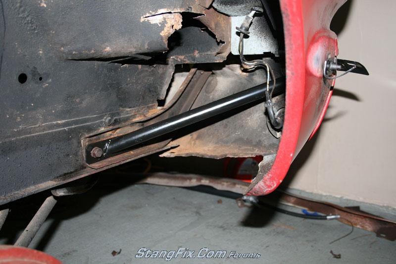

Now on to the next step... repairing the inner fender apron!
Relatively speaking, the rust you show is not bad at all. The back of the fender is normal, and can be cleaned up fairly easily with sanding or blasting, as can the side panel.
I'd worry more about the rust on the front from your other post where the nuts could not be loosened.

Can I use the grinder and a wire wheel brush to clean up all the rusted areas? Then treat it with some rust stuff?
The grinder is too coarse; a wire wheel would work fine. I like roloc disks that you can find at a good paint store for removing paint and rust. They come in 2", 3" and sometimes a bit larger; the smaller sizes allow you to get into smaller areas: nooks and crannies.

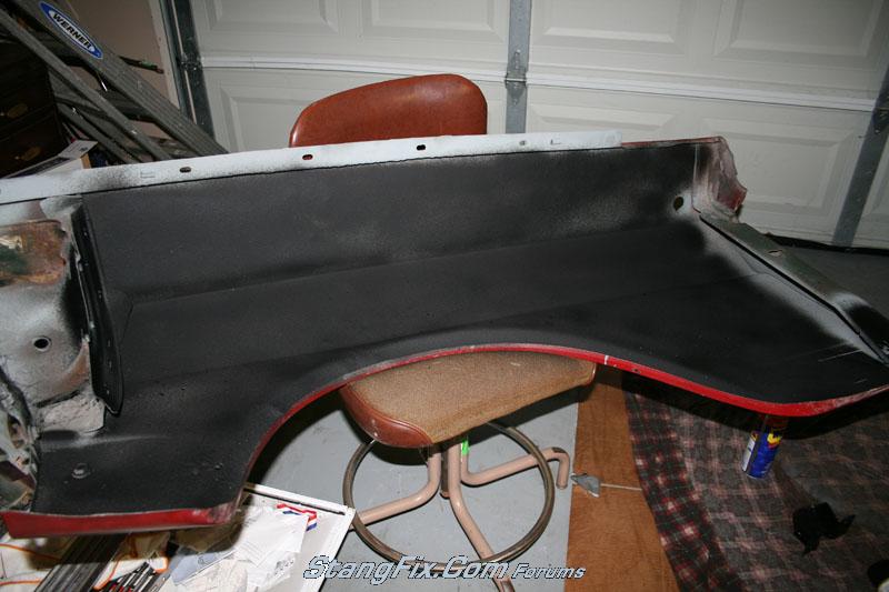

Here's what the fender looks like now. Hard to tell in the picture, but you can see her original color, the dark green, on the right.
I cheated and just used rattle can Krylon rust over primer.. after I sanded it down best I could with the wire wheel. Later today I'm going to spray it with some 3M rubberized undercoating.
Almost forgot the picture of it after I did the undercoating.
