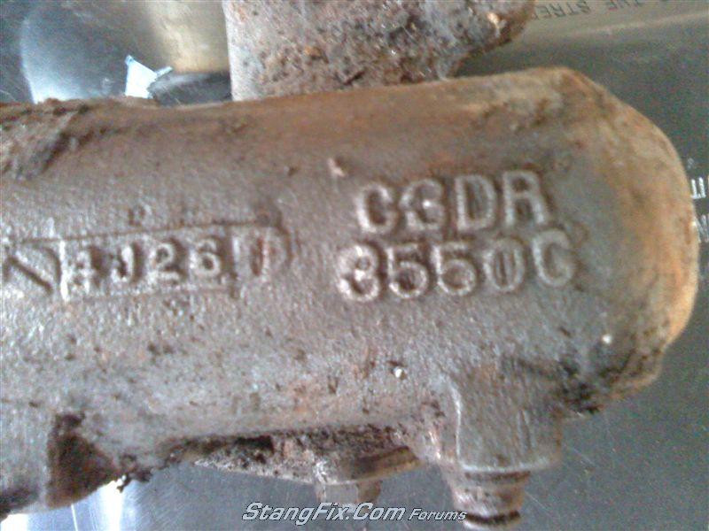

I'll check that out tonight too. Both steering boxes.
And check the steering shaft size... better make a note to myself.

I could not verify the shaft size last night. I could not find my steering wheel puller anywhere. I assume it should come off like any other column - correct? Remove the large center nut and pull? I tapped on the back of the wheel, with a mallet, and it would not move either...

It's exactly 5 turns lock to lock. The pitman arm completes a full 90 rotation.
But now I wonder if it is a Mustang column or not. It's a 'C3' casting...
Definitely not Mustang, but likely a Fal-coon, Galaxy, or other Ford. Someone with a MPC might be able to identify it for you. The differences are most likely not in the gear box itself, but in mounting and shaft length to the steering wheel.
Have you tried a steering wheel puller and PB Blaster? Watch your noggin when it does finally give way!
Can't find my darn S.W. puller anywhere. I assume it's just rusted tight to the knurled shaft...?
Not knurled...the shaft should be splined.
