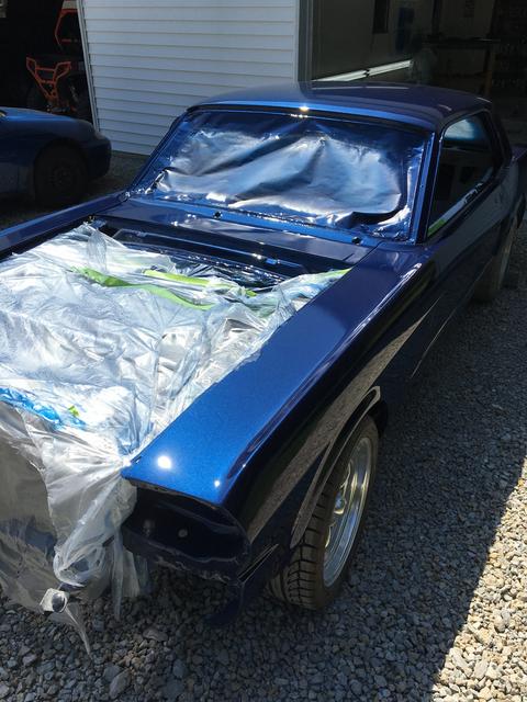

With that...here are a couple pic's. Still trying to remember the in's and outs of this forum. I'll add some more pictures once i figure out the orientation issues.

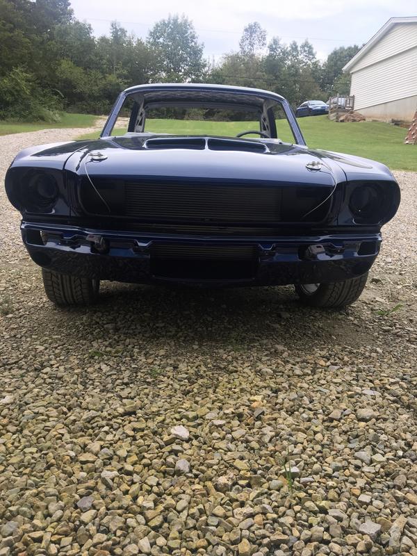

First light
That's looking really nice, digging the color.

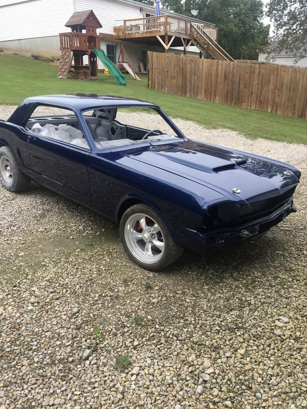

He sent some more glamour shots...

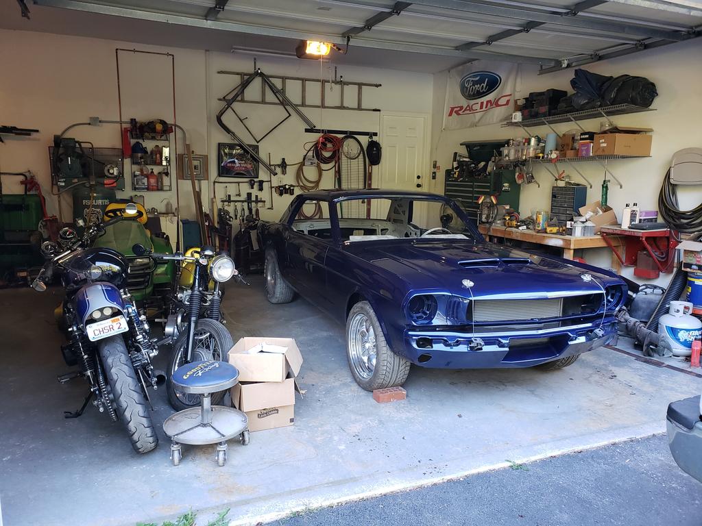

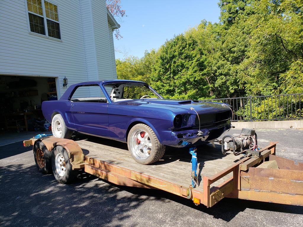

I drug the beast home yesterday morning! Got it unloaded and just sat and stared at it for about an hour.
This morning i put together my "todo" list for basically the next 3 months. I have a tournament to prep for this week so I probably wont get to play with it aside from maybe getting it blocked up in the air. Next Monday the work begins!
