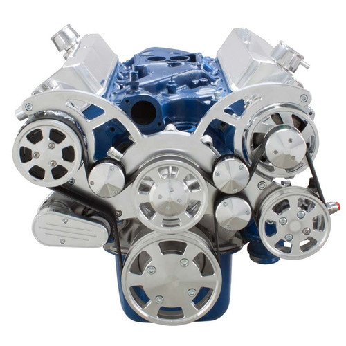

Isn't this what you are looking for?
Man, that looks so much like this, which might be better for your car:
Absolutely !! And its about three times what I paid for my current CVF system. Im going to try and reconfigure my current system to do what this system does. I have a machinist buddy who can turn a few of my items to re-purpose them.
