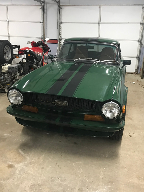

I was kind of cheap and didn't want to buy expensive chrome bumpers. I painted my old worn out chrome bumpers to carry on the rally stripes and of course the British Racing green. I get a lot of compliments.
That is a nice looking TR6! Good color combo.
My car will have the bumpers chromed. The more I think about it and the more feedback I get I am pretty certain it will be the Grey color. I really want the workmanship and details to stand out more than the color. I will just add the color to the interior. [emoji41]
