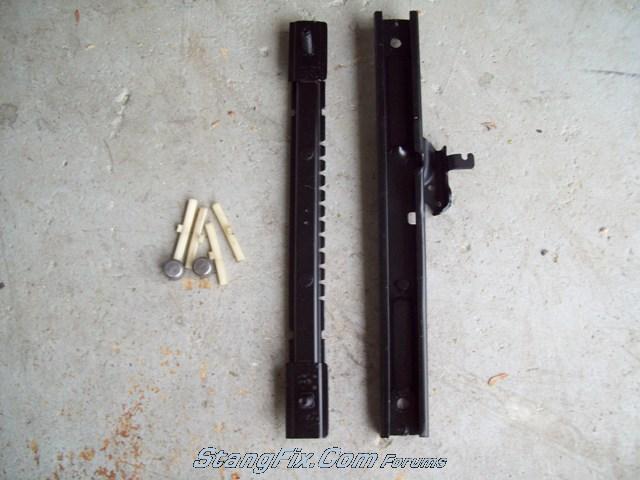

Use the chuck end of an appropritely sized drill bit as a punch. The special rivets are very soft and it only takes a little bit of force to spread them enough to hold the door tag onto the door.
Yeah, if anything I probably pushed mine in too far.

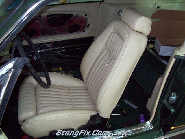

Got the knee bolster done on the front of the seat last night. Hopefully get the other seat done and the tracks installed, but I need to do some work under the dash and get the console installed before I put both seats in. I'll probably just install the driver seat and hold off on even doing the passenger side upholstery until i'm ready to put the seat in. Safest place for a freshly upholstered seat is right in the car, no point having it sit around the shop begging to get torn or punctured by something.

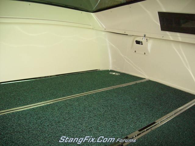

Also,
Sam, there's something amiss with your rear interior trim lower corners..... you shouldn't have that visible "gap". It's nothing to lose any sleep over, but those gaps should be able to be closed up by better alignment of the panels.... something I'm sure you've already tried.... but they WILL align... play with them a little longer.
Also,
You've pushed too hard/far when the punch/drill bit goes all of the way through the rivet.... anything short of that is success!
I know what it is, its that the bolt that secures the front corner of that rear panel and the rear corner of the quarter trim panel is driving that rear panel down. I need to open up the hole in the fiberglass a little to give it more wiggle room which would allow that panel to sit up higher.

Here's that pic with the knee bolster done.

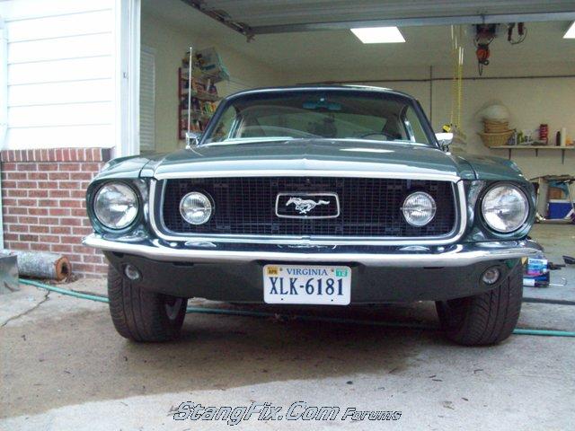

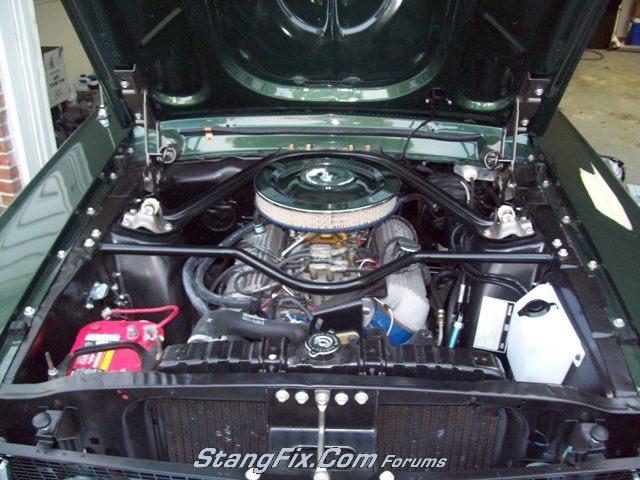

Made some minor progress. Grill is installed with original fog lights rebuilt. Can't find the cover for the middle of the grill molding and I'm thinking I never ordered it for some reason.
Seat tracks disassembled and ready to go back together. They are actually back on the seat now, no new pics though yet.
DONE! Well, driver side could be better, but I'm not fighting that any more right now.

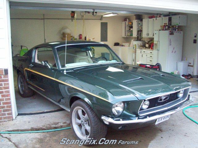

Looks much better with that corner picked up to fill the gap. Trap door is in (still needs adjusted, waiting on prop handle to come in). Driver seat is in. Dash is slowly coming together. I lost spring to work. There was snow on the ground last time I really worked on the car, now I step in the garage and start sweating instantly because its 100*.
Since some of my rear interior pieces were not original to the car, I had a hell of a time aligning my rear panels. Luckily, black panels don't show the gaps as much as your parchment panels do.

Sam,
Which tires are you using on the front? Do the tires have a directional tread pattern on them? Because your's aren't matching....
