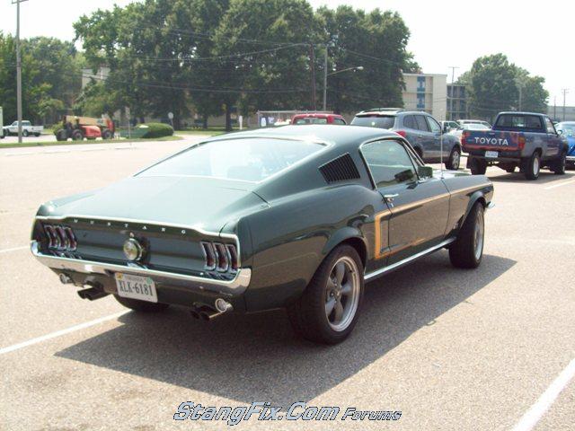

Which tires are you using on the front? Do the tires have a directional tread pattern on them? Because your's aren't matching....
Yes, they do have a directional pattern. I didn't notice when I put the tires on to take it to the body shop 2 years ago and I still haven't rotated them yet. I need to swap the driver rear and the passenger front.

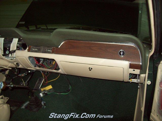

Dash is coming together.

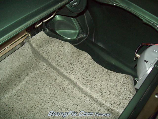

Trap door and trunk
I bought the heavy rubber mat from NPD supposedly pre-cut for fastback. Like everything else, it needs trimmed. I think if I trim a little bit around the filler neck it will lay down flat. I also am not pleased with how short it is cut on the passenger side but assume that was done that was because the spare tire will cover it anyhow. I guess I also need to cut a little notch for the spare tire hold down.

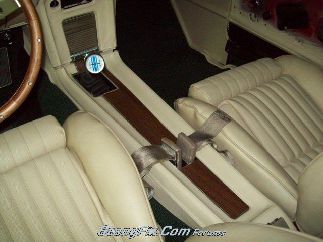

I couldn't find woodgrain applique for the floor console, so I ordered some for the roof console and cut it to fit. I like how it turned out. Its an original console so it doesn't fit as well as it used to, particularly the face piece around the glove box type door and radio area. Seems like it shrank.
I put in the 13.5" Grant wheel for now because its cheap and it works. With the fox seats in there, I need to either lower the seat pans or install a tilt column to get more space between the wheel and the seat for comfort to use a larger wheel. The stock 15" wheel absolutely did not work. When I get to that, I'd like to go with a Motolita style wheel or cough up the cash for an actual 68 deluxe wheel. I think I like the Motolita better and its cheaper so that is more likely sometime in the future.
I tried out the lumbar support for the fox body seats today and that works.
Tires are rotated (see above - Dave called me out for having the directional tires mismatched).

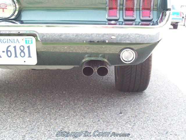

I'm pretty sure I have all the leaks in the brake system fixed - stainless lines and Dot 5 fluid - has been a pain in the ass.
My goal for tonight and tomorrow is to get the exhaust up. I'm going to have a go at it myself and if I can't figure it out, I'll take it to be done. Biggest concern is the pieces that connect to the collector - need to cut that pretty good for it weld up clean.

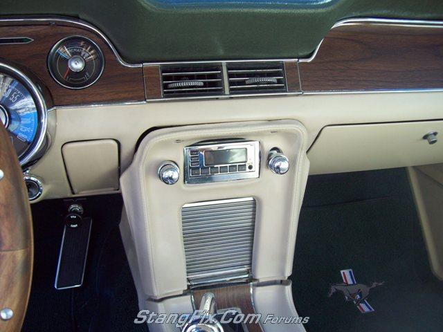

A/C is in, stereo is in, and drove the car to work.
(before Dave says anything, looks like I need to tighten that left screw and loosen the right one to even out that console/stereo bezel.)
