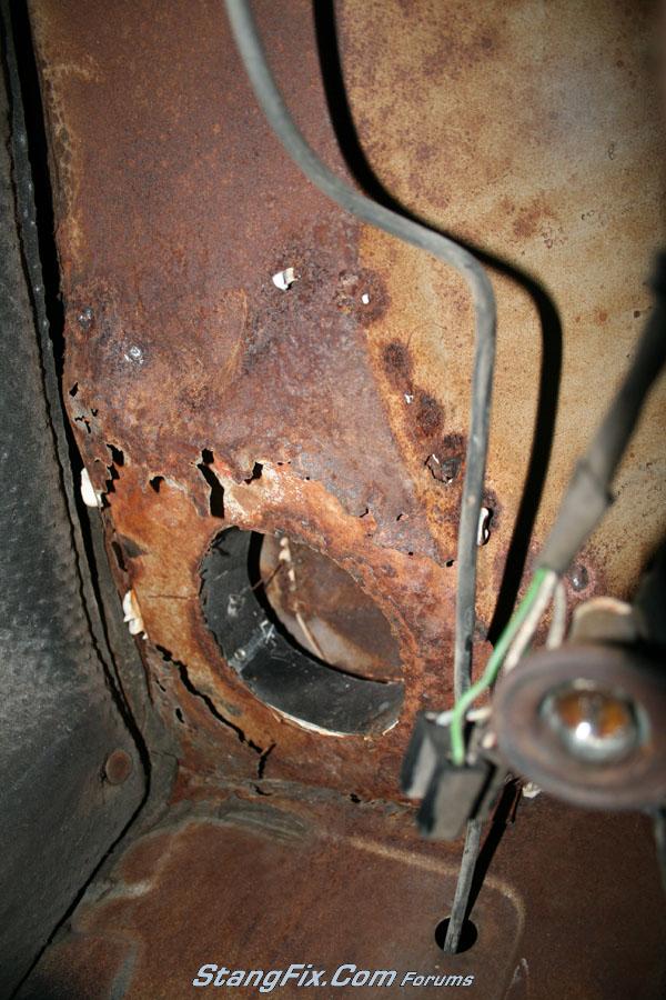

Plus... I remember you stated that your cowl is shot/rusted. This repair alone requires everything around the cowl area to be removed.
I decided I'm not screwing around with the cowl. It can stay shot and rusted and leaky for all I care. Can't drive it in the rain anyway since windshield leaks as well and the wipers don't work and the driver window doesn't roll up.

Okay.... so if I understand you correctly you will eventually..... replace the existing leaking WS with a new one, fix the WS wipers so that they are operational and fix the DS door window so that it rolls up, but then you still won't be able to drive in the rain w/o water pouring in through your rotted out cowl. Understand that this is a unibody designed car and as such the cowl is an integral part of the strength of the overall car. Specifically, the cowl creates a "box" for the frontend of the car to reduce torsional loading. In other words, water leaking through the rotted metal of your cowl is really only an annoying side effect of a severely weakened chassis.
Realistically, the rotted cowl should be the first thing that's fixed on the car.... and to dismiss repairing the cowl while still using the word "restoration" is not a logical statement.

How bad is the cowl......get some pics if you can.
I think I just hurt myself. Trying to take a picture under there, I had to lay upside down in the seat. I'm flexible but that was pushing it.
Could only get a shot of the RH side.
Yep, that's rusted all right.
Ouch..... I would really take the time to fix that. Small amounts could be patched easy.....that is major. Sounds like you could find some locals to help you. Enough help and planning and it does not take long.
By the way, just sticking the camera under the dash and shooting several pics at different angles normally gets the shot you need with out the flexibility problem.
And getting worse by the day. As they say "Rust never sleeps" whether it gets wet again or not. The damage is done and will continue to eat it away just like Cancer.
