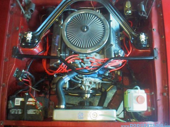

I could have put a battery in there if I wanted. There is enough room without the oil cooler. I don't think you will have to move the radiator to the side. Here are some photos of the work I did to the radiator support.
I know this is an unpopular mod to do to the cars but I wanted the added cooling of a cross flow radiator. The down flows don't cool as well.
My overflow is the same as yours and it's in the fender well. I like to make the tech guys stand on their ear to see it.
I used a set of upper radiator mounts to make some lower moutns. There's a rubber bushing under it for a cushion. The top mounts are just all thread mounted to the top flange.
I've had the car like this for a long time. It came with a down flow and that didn't keep the C cool so I put in the cross flow and the cooling issue was over. I don't even have a fan on the motor, I use an electric fan on the back of the radiator and the only time I turned it on was in traffic. I didn't use in on the track or on the highway.
That's actually less cutting that I was thinking, you just opened up the back side of the indent. That's pretty straight forward and gains about 3-4 inches almost per side of open flow (at least thats what it looks like)
This would be the only real 'change' I would make to the car that isn't easily reversible (sub frame bars and torque boxes can be removed pretty easily). But considering I do run a 410c, 1 3 link rear, and really am far from stock....I need cooling
I had been considering taking the entire indent to gain an extra inch forward the whole radiator assembly could sit. Giving me more room between the water pump and fan setup
