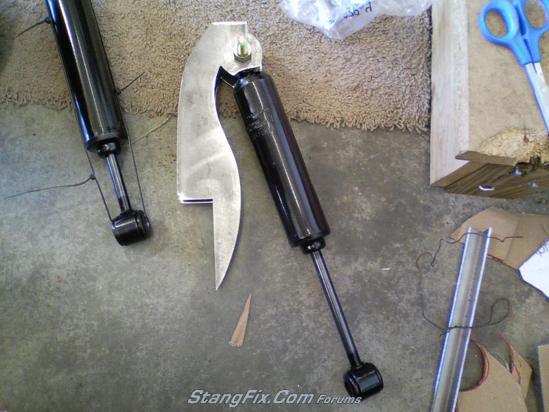

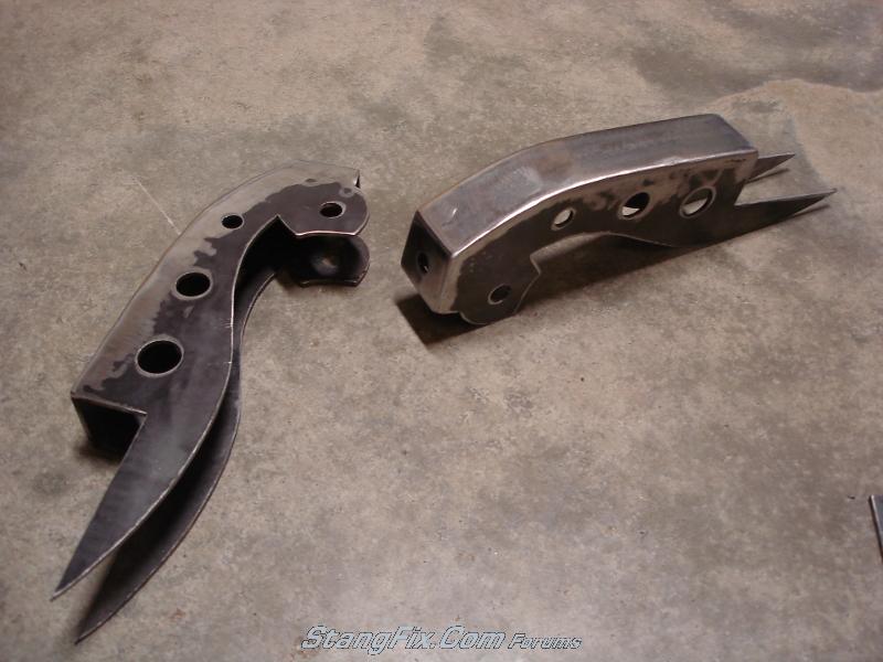

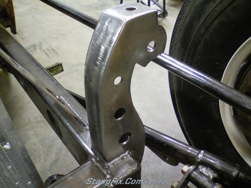

Small update. Fab'd the combo shock mount & headlight bucket mounts.
Cut out 4 identical pieces on the band saw.

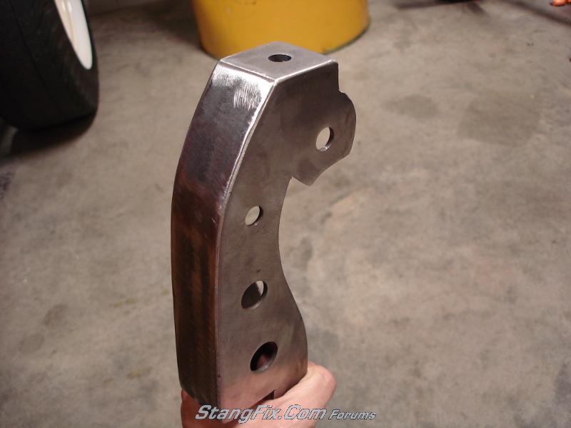

Boxed in & smoothed the brackets:

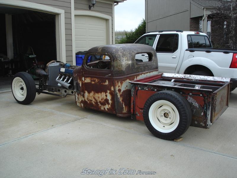

Mocked in place:

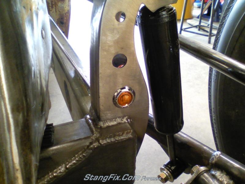

Burned in:

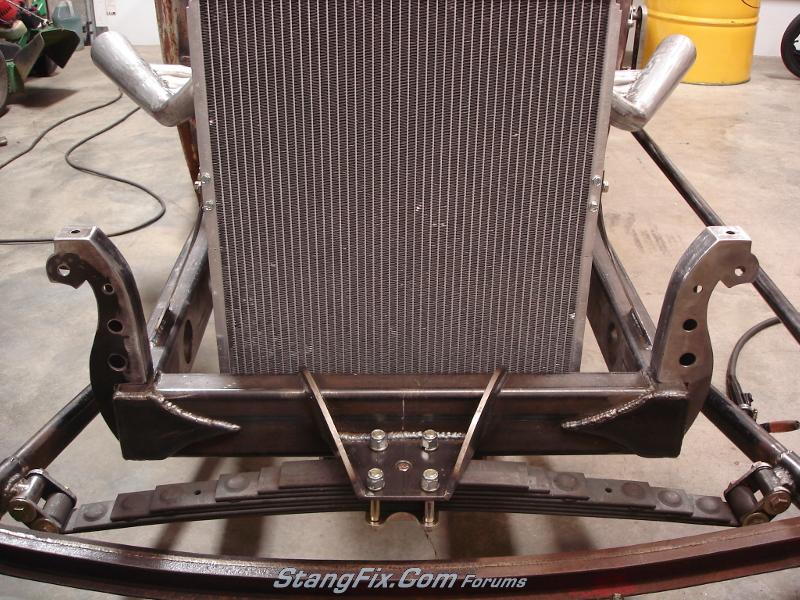

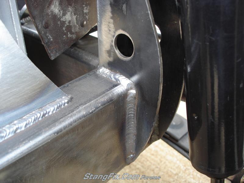

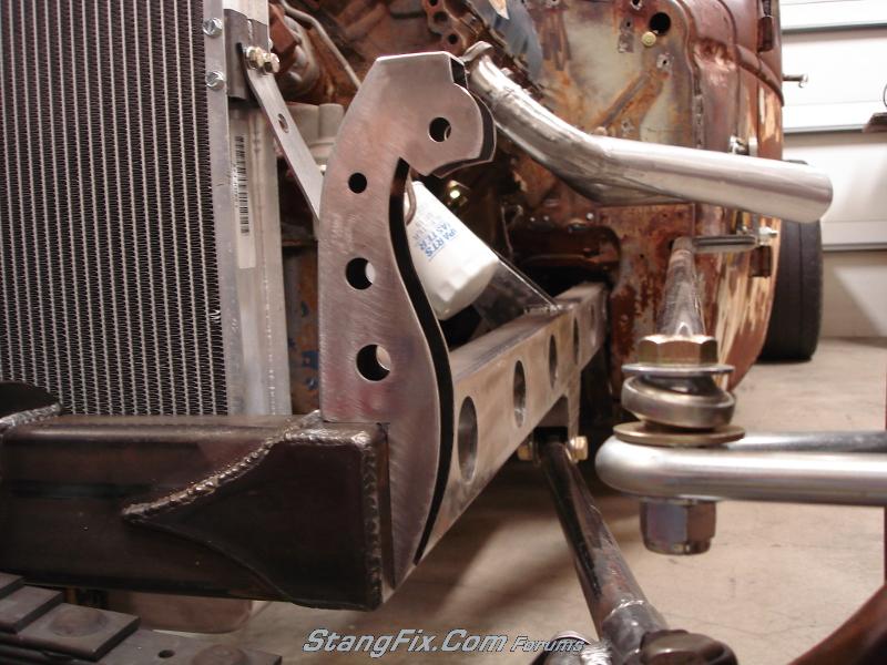

I also welded on a 1/4" thich reinforced dogear on the botto of the radius rod for attaching the lower shock mount.
Assembled together:

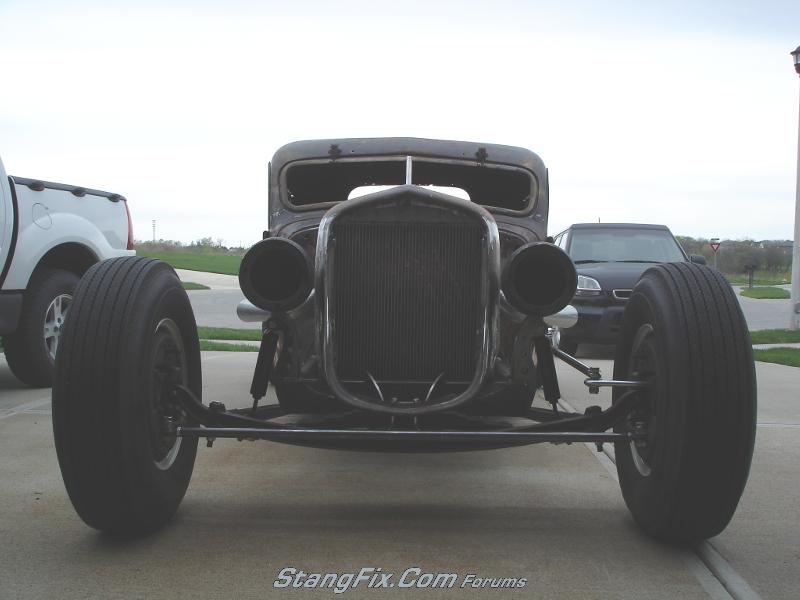

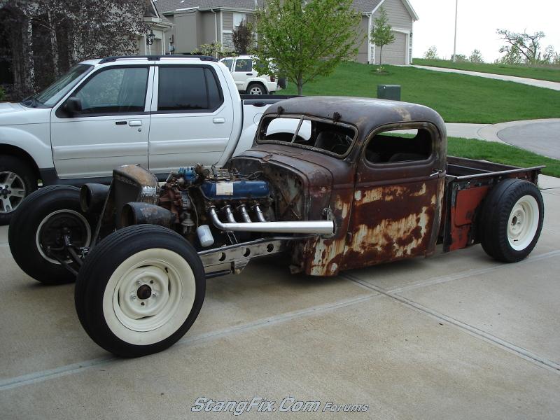

I may move the buckets back some more - not 100% sure yet:
And they need to be adjusted down in the front... LoL

The wiring will exit the bottom hole in the bucket and whip into the bracket via a short piece of MC cable - so the wiring will be basically concealed from view.
And... semi-hidden turn signals. I will have to scuff the finish on the bezels and coat with my rust converter to obtain the bronze look still.
Sweet....I would not move them back. Part of the "look" to me is headlights that really make a statement.

"abrahamfh" said:
How do you get you vertical welds to look so clean?
Skills? :shrug
