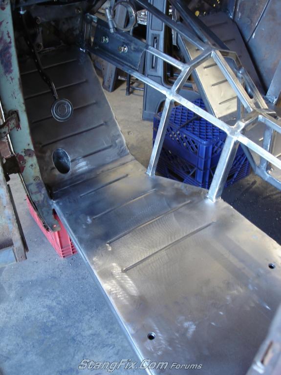

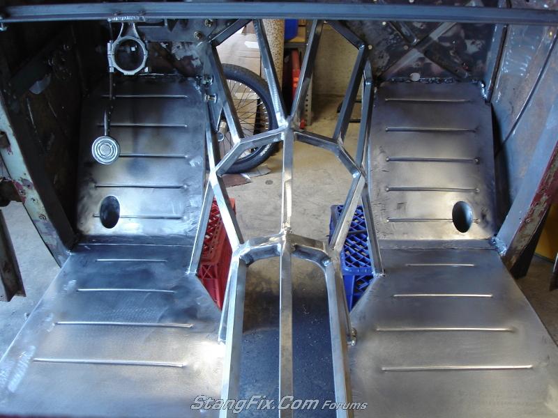

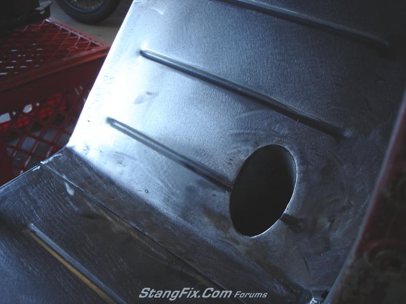

I did get the fab'd floor pans & toe boards all installed and smoothed:
The holes in the toe boards are sleeved access ports to the body to frame bolt:

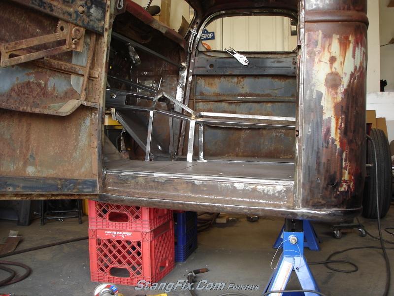

I cleaned up the rockers some and re-installed them. Blended in:

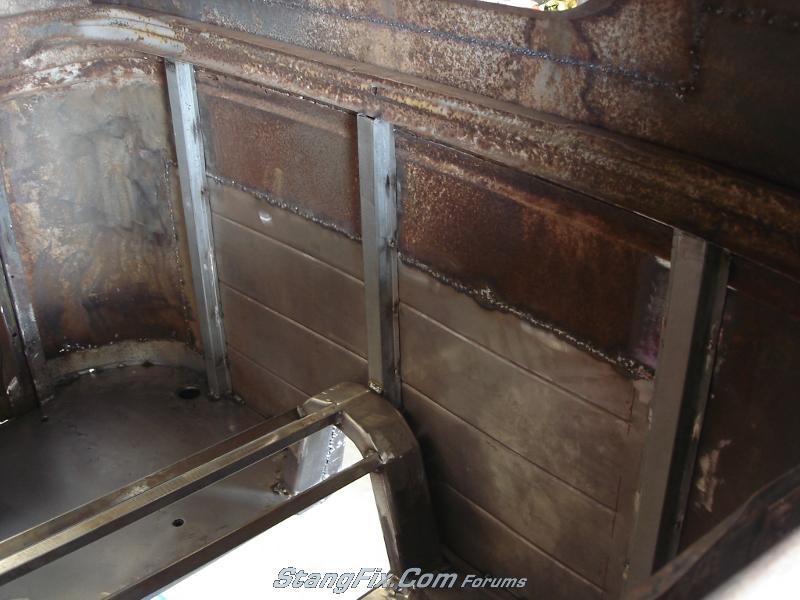

I finished up the rear sheet metal and welded in some vertical braces to help stiffen that wide span of metal. Those welds will not get smoothed because they are hidden by the inner cab panel:

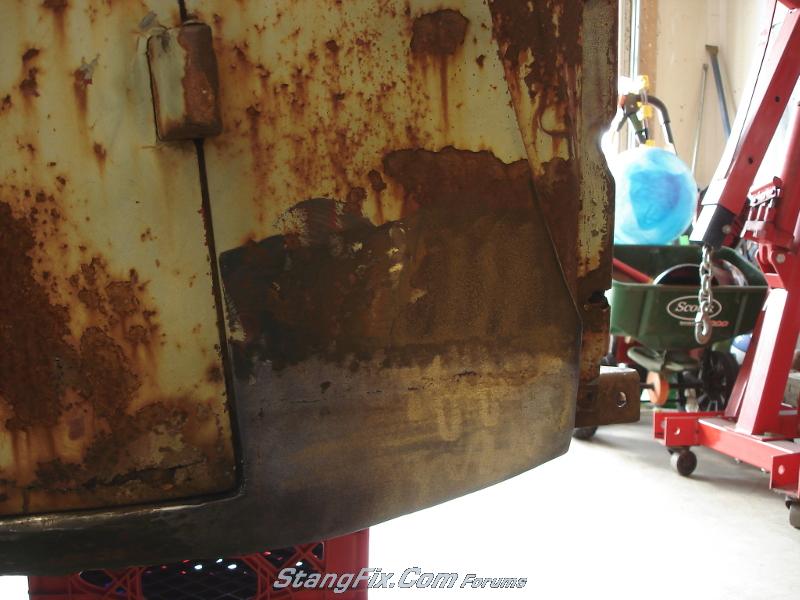

Next I cut out some more rot from the lower, passenger side cowl and formed a new patch. Welded & smoothed. I also reinstalled the passenger rocker and blended the patch into the rocker. That rocker panel needs some more work - it's lumpier than a fat girls thigh:

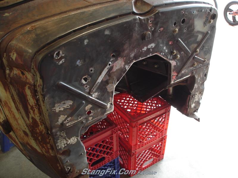

Moved up to the firewall and started filling holes. I have about 30 or so left to do... ugh. I did form & roll the trans tunnel lip as well:

Did you form the parallel rolls in the floor boards yourself, or did the sheet metal come like that? If you did make the rolls, how did you do it? Just curious...
These are the indentations in the flat sheet metal that are put there for stiffening, IIRC.
Yes, I rolled those beads into the sheet metal. I have a Woodward Fab beadroller now. Those were rolled with a 1/4" die set.
