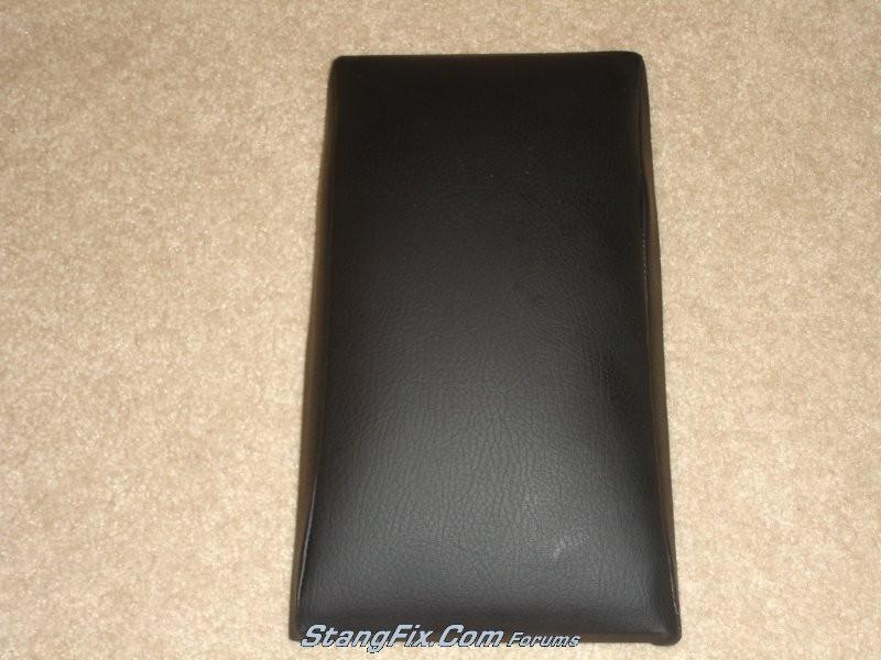

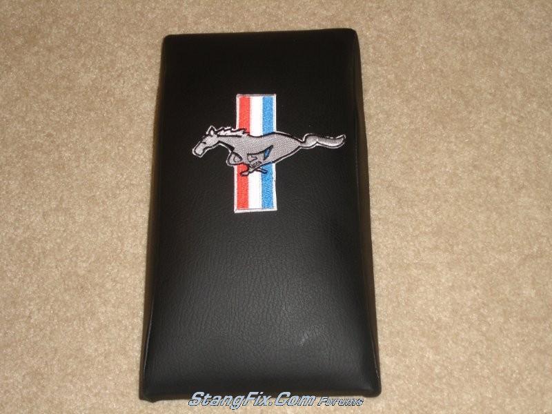

After giving the vinyl a couple days, i re-stretched it over the arm rest. Now i need to decide if i want to logo it or not. What do you think?
Depends. If you're just going to use a patch like the one photographed, I'd pass on that.
If you're going to have an embroidery shop with a fancy computer controlled embroidering machine do it, it might end up pretty cool. For my money I'd go with just the running horse and leave off the tri-bars, but that's a personal taste thing. I'm kinda over the bars.

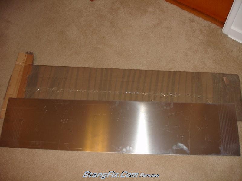

There was a loud ring at the door today, and it was big brown truck. :yikes Big thanks to gotstang and AtlantaSteve. These guys helped me find this awesome piece of 1/8 inch thick aluminum. It will soon be the base of my console from under the armrest to under the radio. The finish is lacking at the moment, but i think some elbow grease could solve that issue.
Now the real fun will soon begin.
It was that e-bay auction. Good stuff. Its a strong piece, and for 53 inchs long, i was surprised how rigid it is.

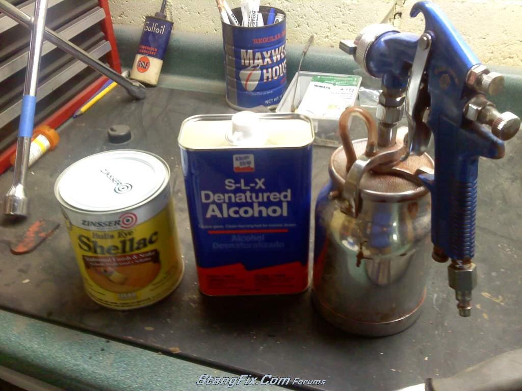

After much debate and some research, i went with shellac as my sealer of choice. It needs diluted with alcohol in order to be sprayed properly. I see the common finish, is 2 parts shellac, to 5 parts alcohol. I found that with my oldest primer gun, with a 1.8 inch tip, that a 1:1 ratio sprayed nicely. So i went with that. After one coat it was obvious the color of the piece changed immediately. The shellac really seems to darken up the mdf. I put 3 heavy coats on. And i mean heavy. I wasn't trying for runs, but i got one. and when i went back for the second coat, the run actually dissipated out into the piece. I was shocked because now there are no sighs of it.
As evident in this piece where ever i got the wood glue, the shellac would show much yellower.
On a few Audio Forums, the sealer of choice for mdf is a 50/50 ratio of Yellow glue and water, I was reluctant to put anything with water on it, so i went with the shellac. I think the yellow glue may have done the job too. It appears to have worked well in that pic.
