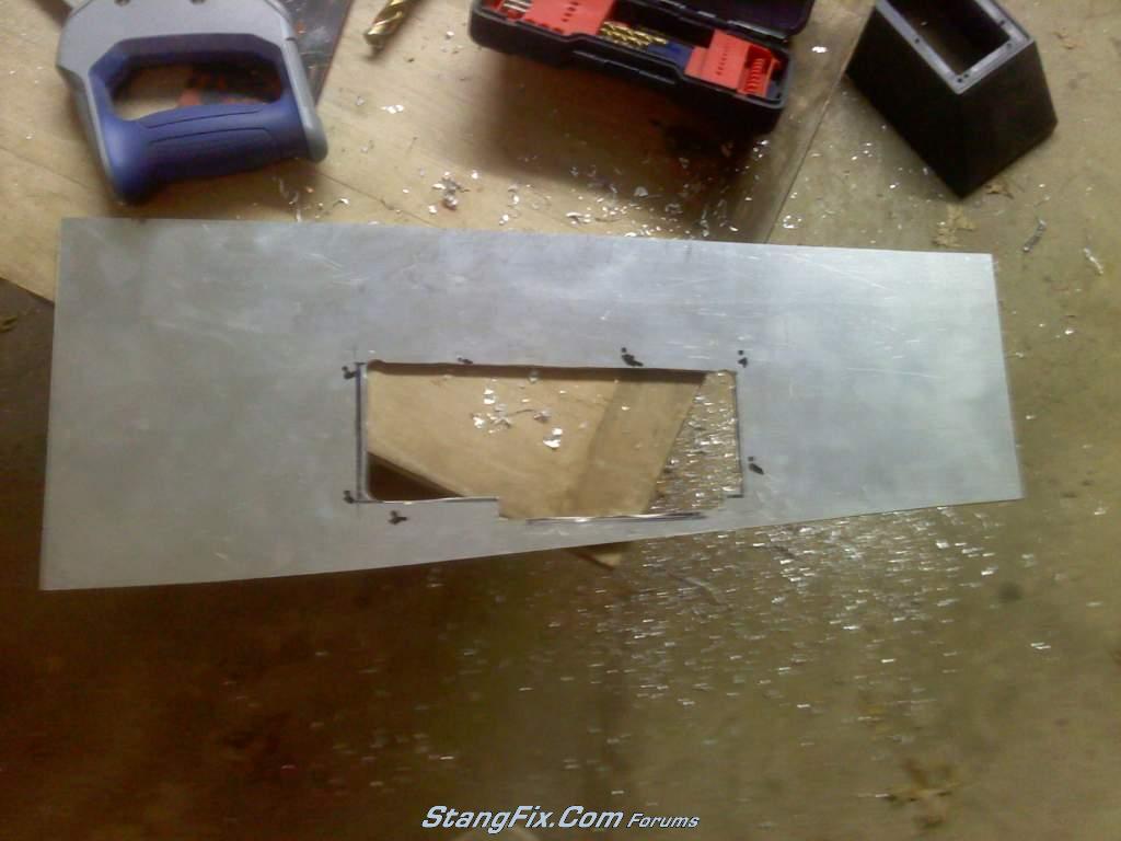

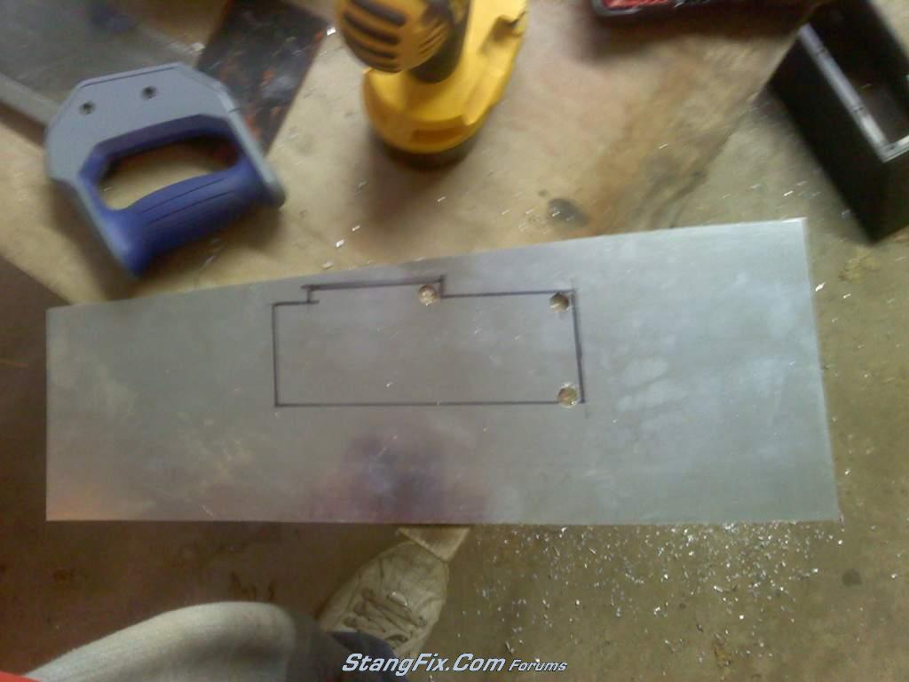

[member]I cut the base out to fit around the shifter.
Marked a more exact hole in the aluminum Piece

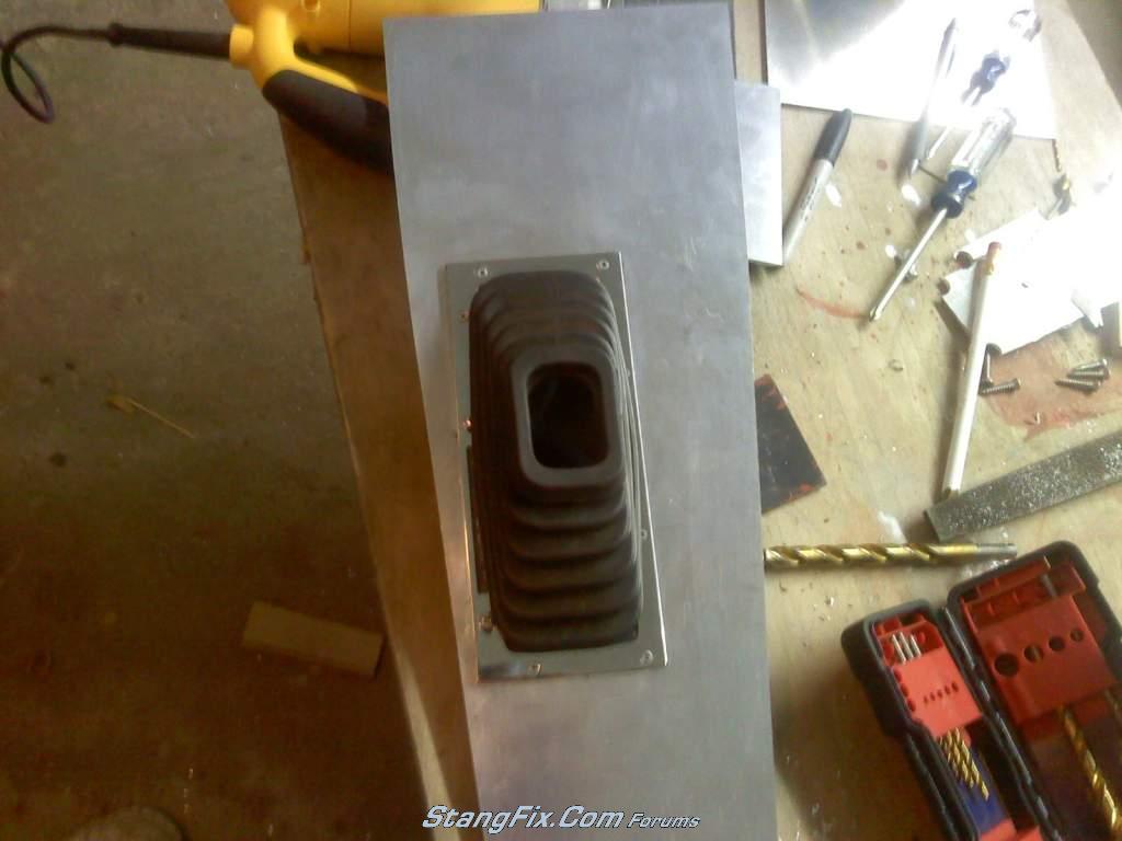

Cut it out rough and filed it smooth. I also marked the location of the trim bezel for the shifter. This is a pic of the rough cut.

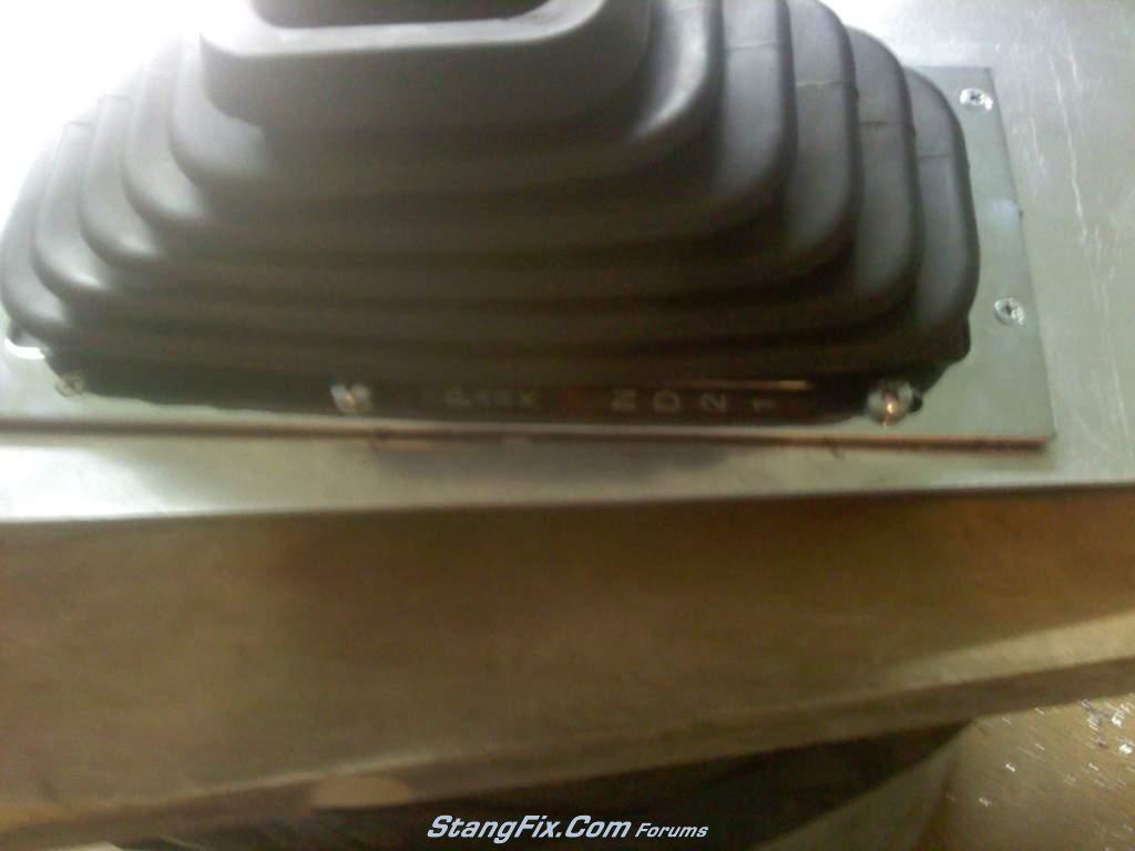

Then i mounted the bezel.
[/member]

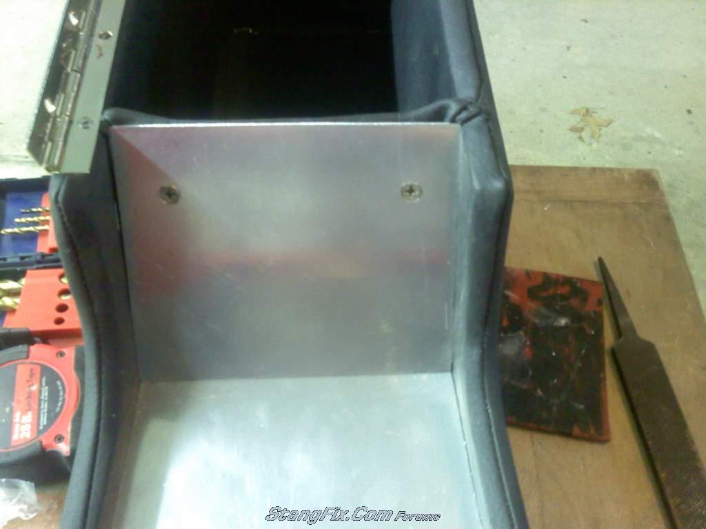

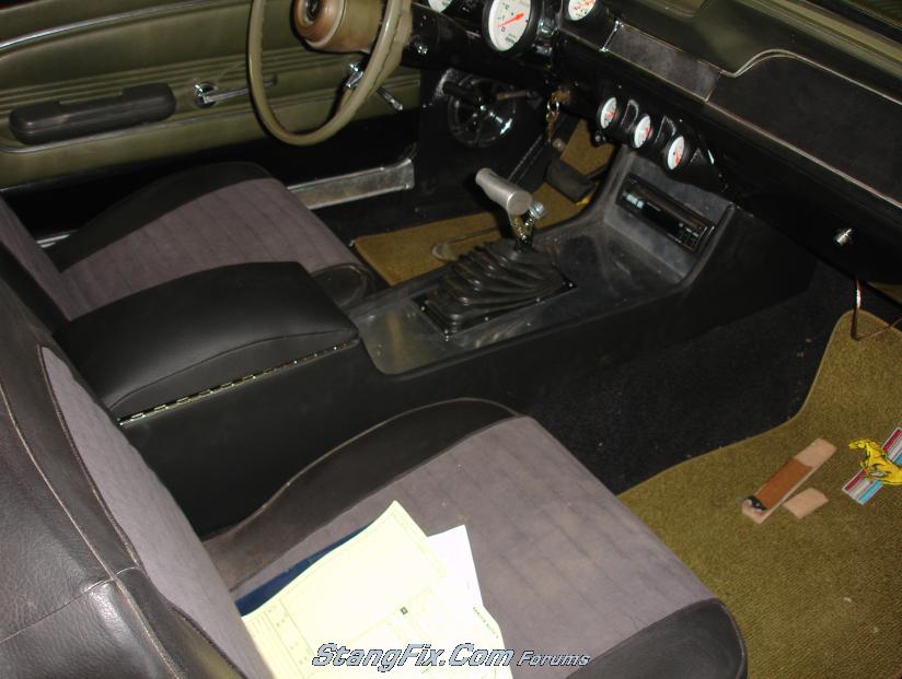

[member]i Mounted the back plate with two nickel screws. The kind that hold door hinges on. I counter sunk them in the aluminum. When the glove box is closed, they are located high enough that they are not even noticeable while sitting in the car.

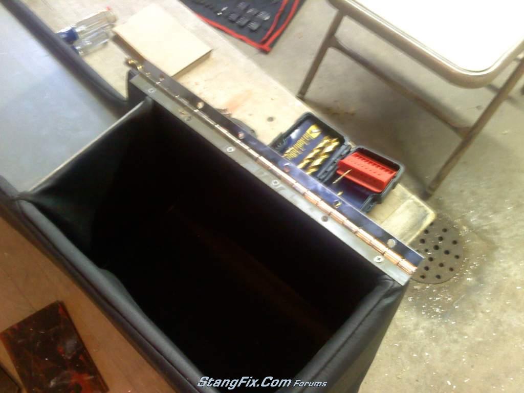

I purchased a chrome piano hinge from one of the big box home centers, it mounts nicely on the mdf, and feels real secure. it also hold the glove box lid in the open position with no problems.
I used a radio delete gauge bezel and mounted the radio in the console. I figure the radio is easier to remove then the gauges if i ever need to get under the console for somethig.

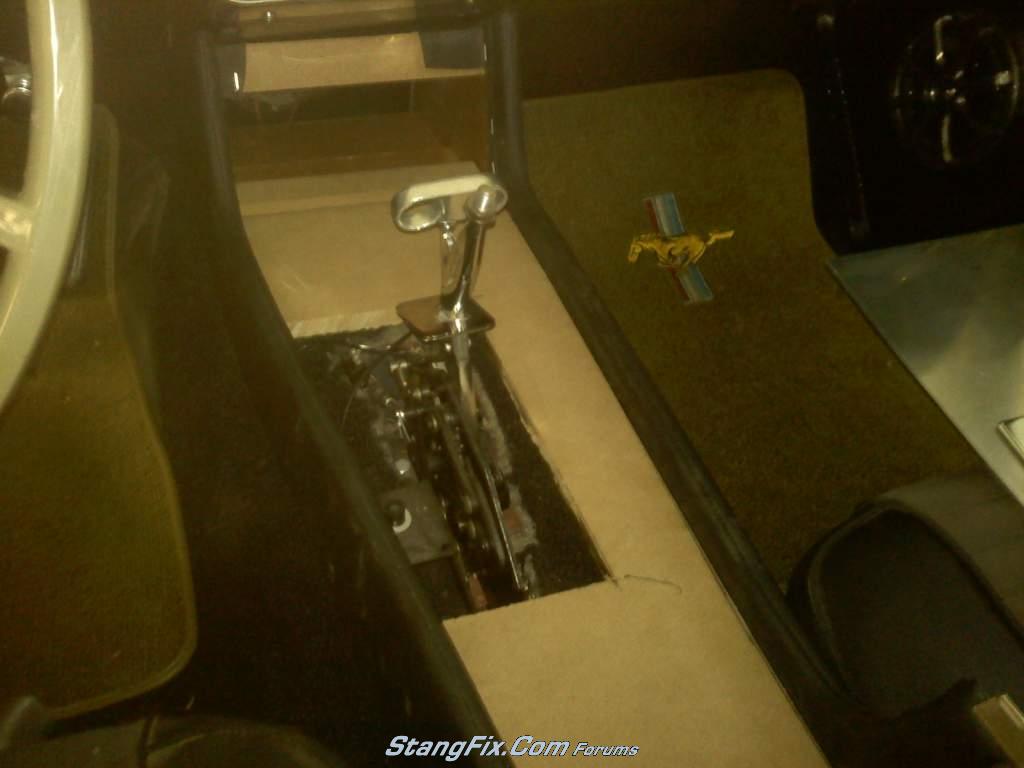

Pretty much a final pic showing the overall placement of the console. I can say this, im glad this project is now behind me.
[/member]
Only thing needed now is a good cleaning and detailing of the passenger compartment. There is saw dust and finger prints on everything. Its shown in the pics, so i will post new ones once everything is cleaned up.
