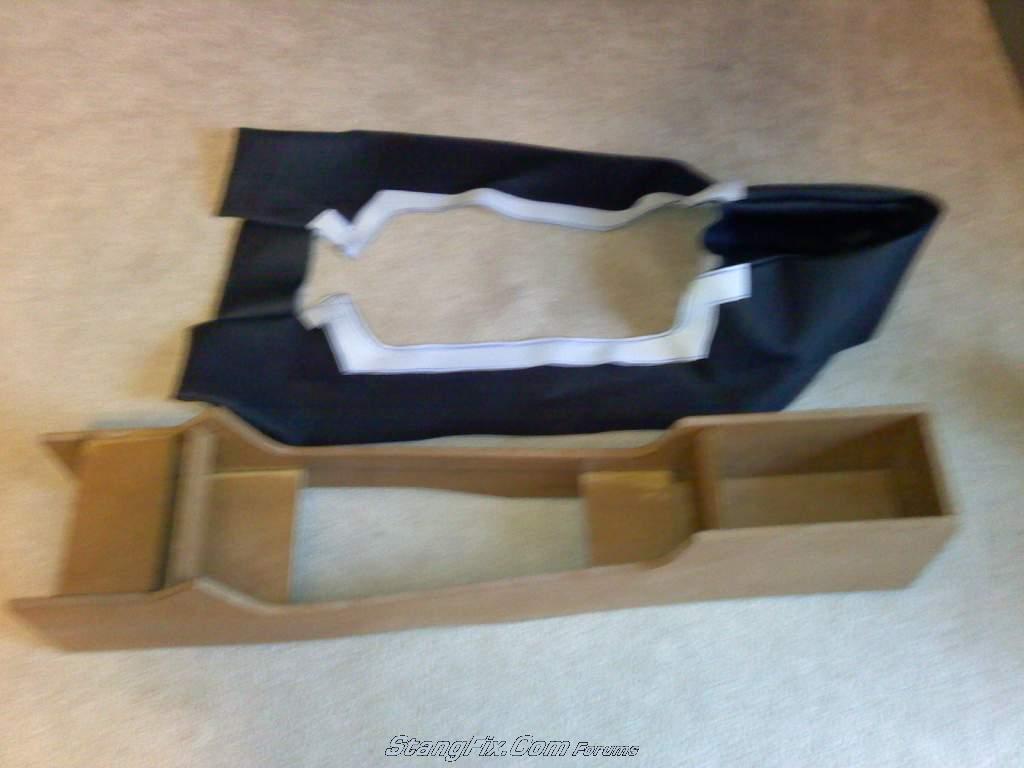

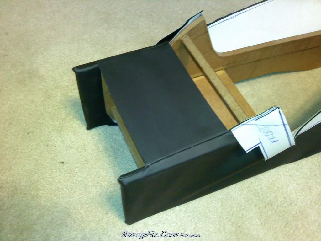

When i made the console, i made a third side to use as a stencil for the upholstery. I laid it out on the table to trace out the pattern for the vinyl.
All sewn up. I never noticed the pic was blurry but its the only one i have before i started to fit it.
I made the front so it would slip right on pull itself tight. That way i wouldn't have to stretch it as much.
The back is the same way, once its pulled tight over the glove box, the front would help to eliminate a bunch of possible wrinkles.

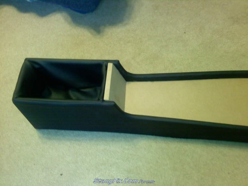

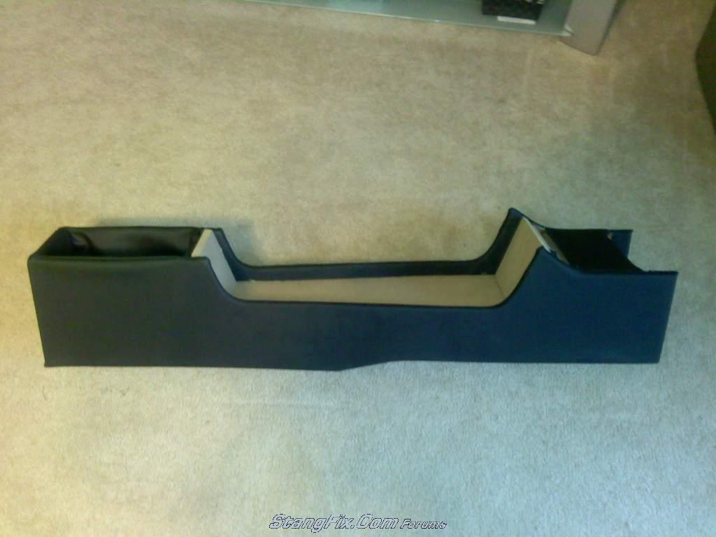

Here it is, stretched out, and stapled.
I still have to stretch out the glove box area. I dont want to just staple the bottom down, im thinking about trimming with a piece of aluminum on the bottom. We will see once i start cutting up the metal.

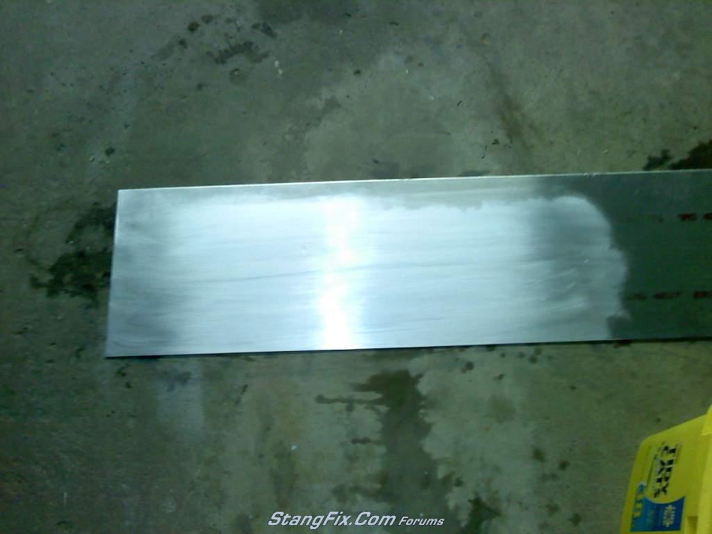

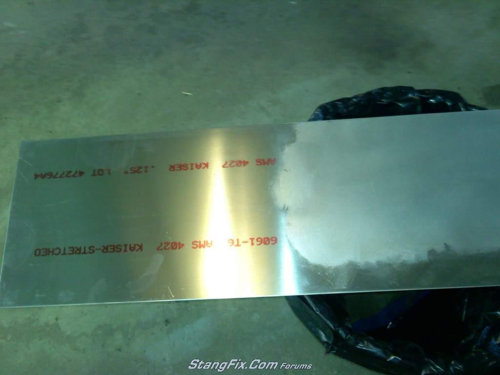

So since i got the aluminum, i have been prepping it as time permitted. It had some minor nicks and scratches, so i started with some 220 grit on an orbital sander. That basicly cleaned up the consistency of the metal. I followed up with by hand with 600 grit, then 1000. Finishing off with my trusty buffer and some compound. When it was done, it was near mirror finish with just a slight haze. However, i think i want a brushed look, in sunlight it is really reflective, and i think that might be annoying while driving.
220 grit
600 grit

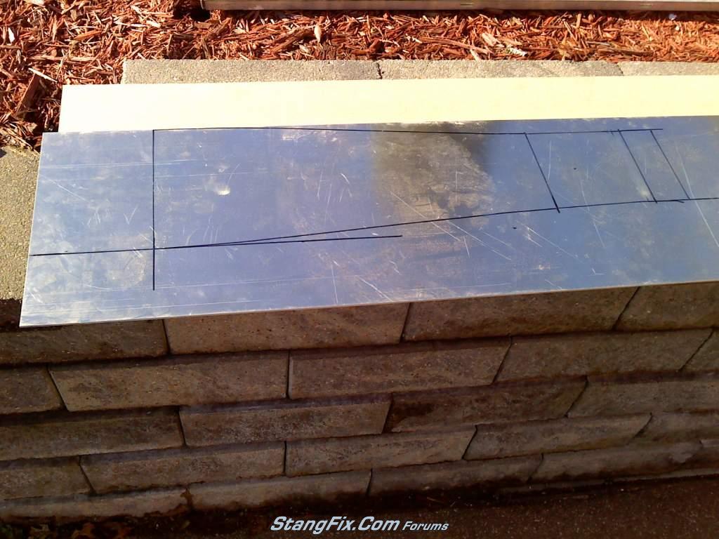

This is the layout of the console, here you can see all the nicks and scratches. The side i finished is the bottom side in this pic. The plan is to cut it out maybe a 1/16th big so i can file it down to fit perfectly.
My weapon of choice for the cutout.
