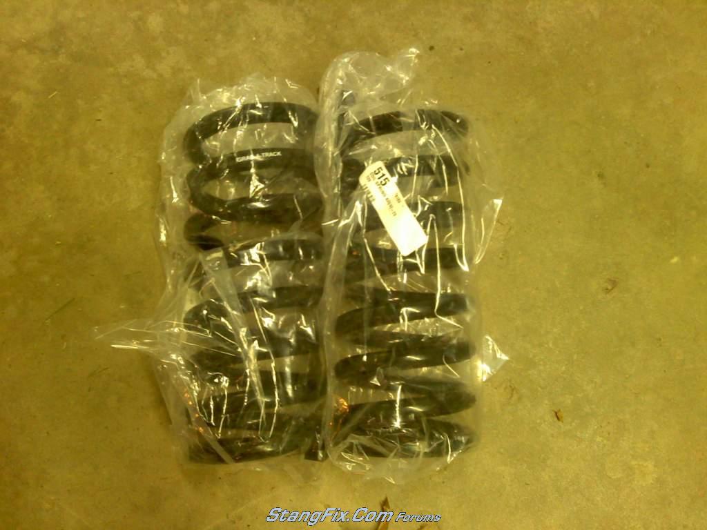

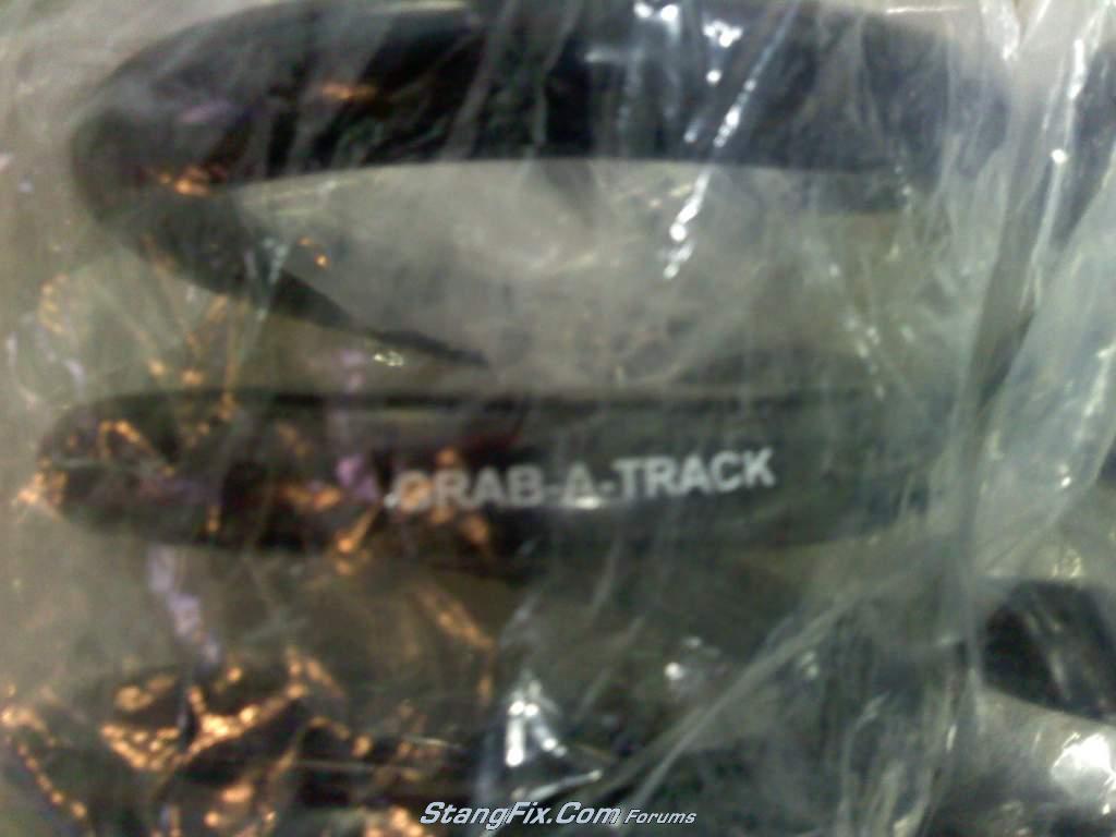

[member]You know the saying, without pics, it never happened. Well the springs showed up today. Hope fully this weekend i can get a chance to put them on, and stretch the legs a bit. Funny thing, I bought the springs from mustangs unlimited, and they come in a mustangs plus box, with a Mustangs Unlimited receipt. Are the two places sister stores or something? I got some other things too, and the smaller Plus box was inside a bigger Unlimited box. Odd.
At first glance, these appear to be smaller then my stock springs compressed, of course ill take photos and have a write up later.[/member]
Mustangs Plus is the supplier to most of the vendors for springs. They have them made here in Calif. and shipped out. Both coil and leaf springs. When you buy mid eye or reverse eye springs, that's where they come from. They also have their own sway bars made in Calif. by a place that makes sway bars for diesel trucks. We sell a LOT of their springs and sway bars. Addco is another source for sway bars and Eaton springs is another one for springs. I like the quality of the Mustangs Plus springs so we stick with them for our kits.

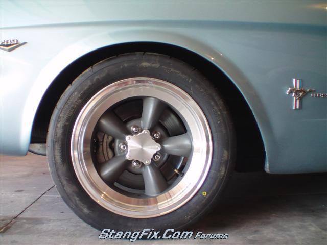

Maybe you need to bite the bullet, and build a better gallery here mark. What did you do to get the wheel tucked away like that?
620# Grab-A-Track Spring with 1/4 coil taken off.
Arning Drop
16x8 225/50
Fenders rolled as much as possible
Roller Perches
It's a tiny tire! Those are the Nitto NT-01, 225/45-15 that I have on there now. The 215/60's and the 6.00-15 Goodyear Bluestreaks take up all the space.
Arning drop, dbbl roller perches, stock upper & lower arms, adj strut rod, 620# Mustang+ springs (no cut), rolled fender lips, Koni shocks.
