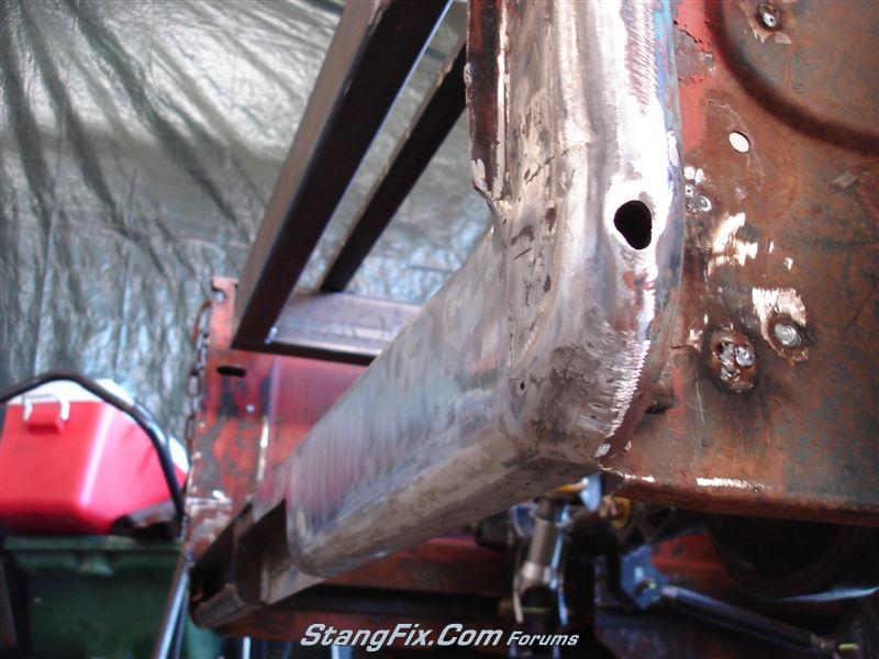

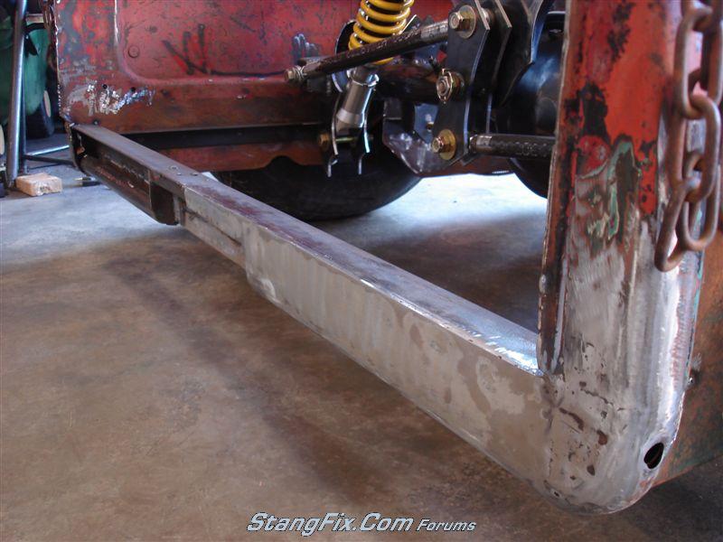

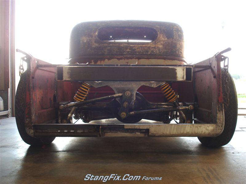

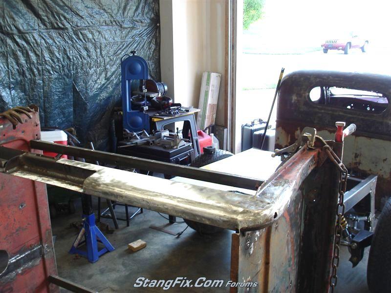

Been a while since I updated and actually made any progress too. I spent all day Saturday at the swap meet selling stuff. I cleared about $255 dollars after paying for my rental space. I cleared out almost all of my excess mustang parts.
I finally meandered my way out to the shop mid-day on Sunday.
I was going to work more on the inner bed structure frame work, but I decided to start over because I didn't care for the look of what I had done so far (which I never shared because I was torn on the look). So I cut everything back out and started over. I decided to eliminate over half of the steel that I was using.
I settled on just starting at the bottom structure below the tailgate - which was rusted and gone anyway. I had temp'd in that one cross brace to keep it somewhat solid.
For the lower cross structure I used two (2) pieces of heavy angle iron and formed a 'C' channel and spanned from side to side, tie-ing into the side reinforment uprights. I worked in a curved roll pan into the structure as well with a recessed license plate housing.
Driver side still needs to be skinned & finished.
The recessed license plate housings is pretty deep. I'll have room to install a little LED license plate light
The curved end with the dimples is where the tailgate hinges go - hence why they are not dressed up better.
I'll dress up the plate area a bit more when the opposite side skin is on.
The license plate may hang down too low though... LoL
