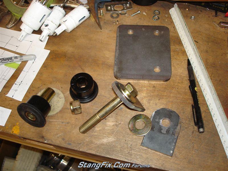

Again, everything was hand cut on my bandsaw; all 1/4" steel plate, for the block plates and frame mounts.
Making the block plates:

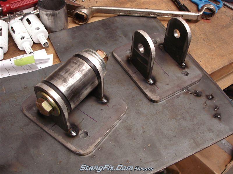

Just tacked together here:
Fully bushed engine mounts. The cross tube is 2"OD - 1.5"ID - 1/4" wall DOM tubing. 1-15/16" wide to accept the bushings:

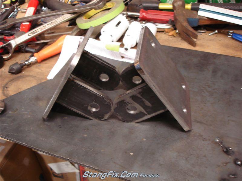

Partially welded to the frame:
This is where I had to remove the engine and remove the bushings so I would not melt them from the heat when welding. Plus I had to access the underneath side of the mount to weld it also.
The inner webbing is fully welded on the back side - I didn't want to see a bead on the front of it.
Bushed with the 9/16" ID inserts:
I like them. I was going to fully box the brackets in, but honestly I'm tired of boxing stuff in! LoL. So these are open. And I think the holes match the front portion of the frame as well.
