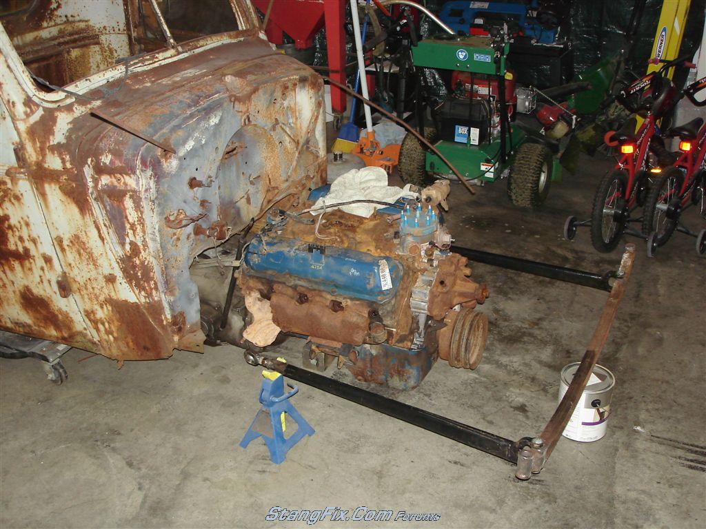

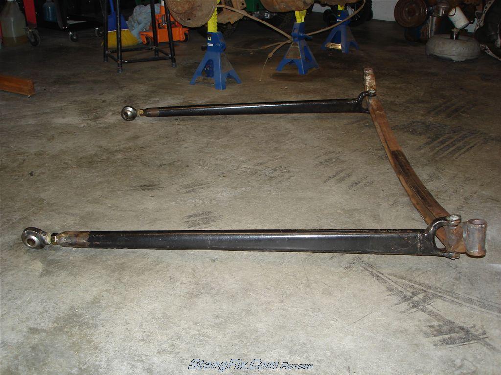

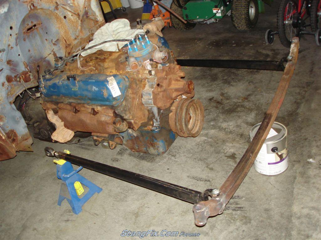

Well I picked up the front drop axle & radius arms this weekend (split wishbone setup). Next up will be the mono-leaf spring, spindles, etc.
Check out those heim's joints - they are huge. The I.D. of the pivot hole is 3/4"!

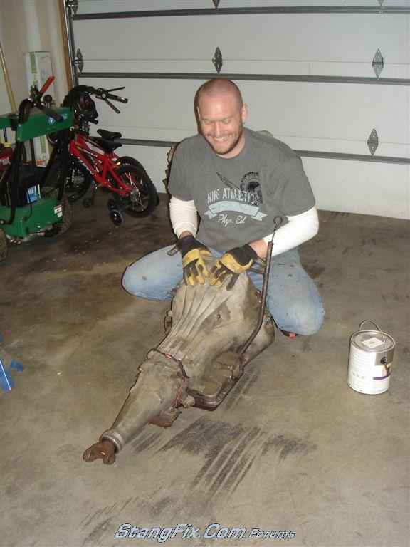

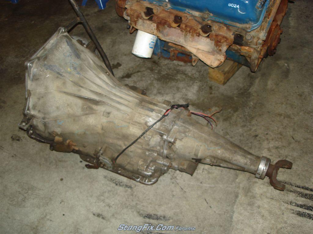

Also picked up this "low-miles" rebuilt C6 tranny w/ converter for a cool $50
Showin' off my huge trans...

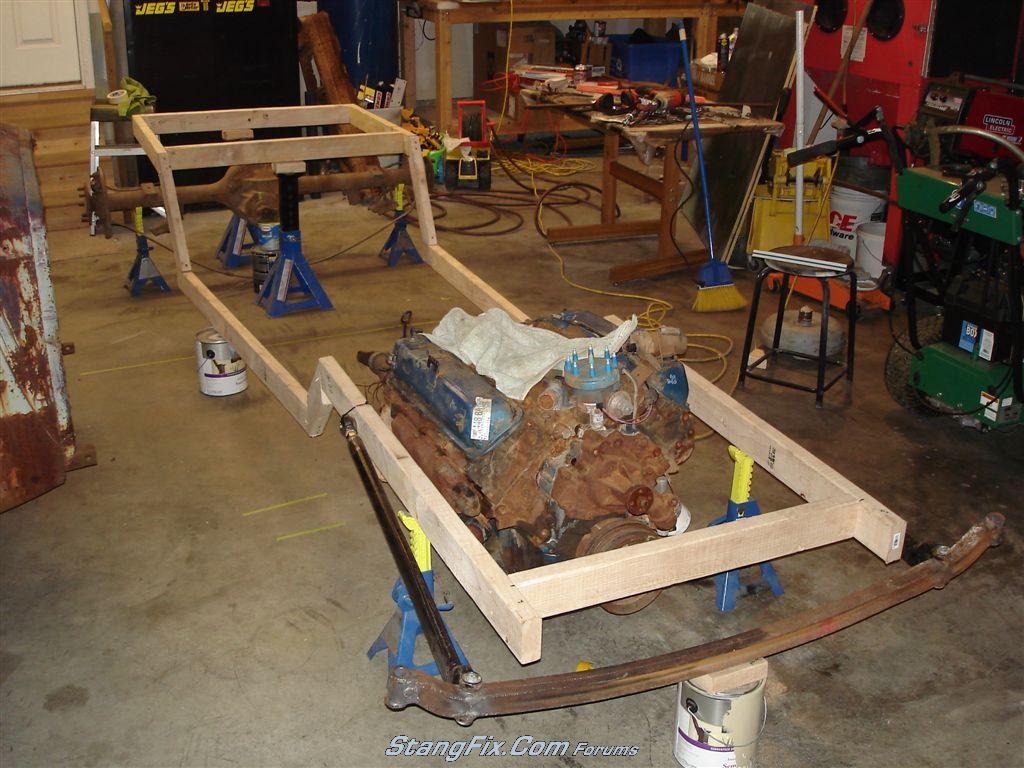

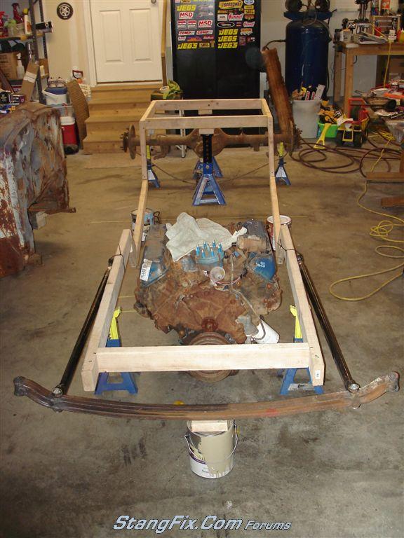

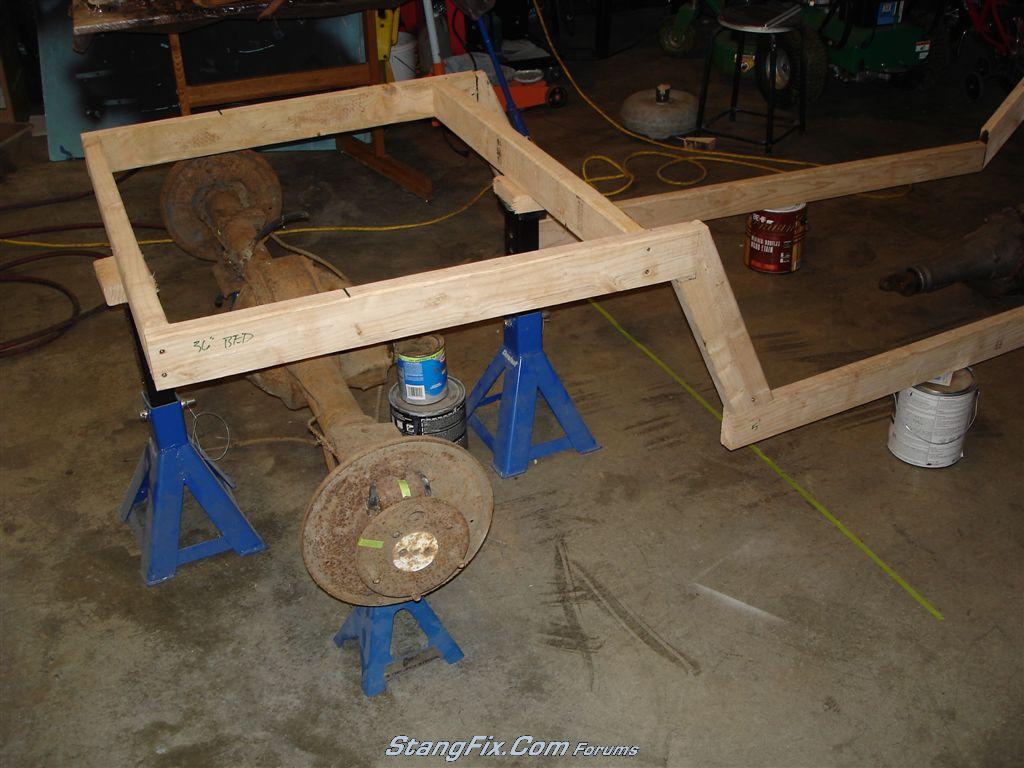

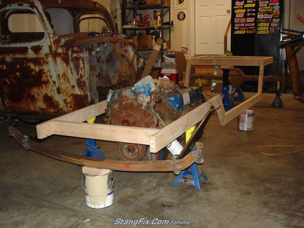

Next up was to start mocking up my frame. I decided to mock it up with wood first to determine angles, lengths, etc and then I can fine tweak it with the steel. Hope to pick up steel next week - just need to price it out... :sad I will be going with 2"x3" rec tubing.
Started laying everything out to figure a length...
Didn't take many "in between" shots... sorry.
The front end is not complete yet... I really need my spring and mount to finalize that...
The bed/box will be a 4' box -basically even with the back of the wood - and extending 12" over the "Z". The axle will not be centered under the box - but 12" off of the end.
I have to run to Dad's shop to borrow the cherry picker again so I can get the engine up where it goes & build a dolly stand for it.
Plus I want to brace the frame and drop the cab down on it to see how it sets with the front "Z". The body will be to be channeled a few inches to get it sitting a bit lower. But I wanted some decent clearance under the frame. As it sits now, it's at 8" to the bottom of the frame.
ANOTHER automatic J? Can you drive a stick?
Yeah, I can drive a stick Rick. But this tranny was CHEAP and will be an easy install. So those factors won out.
