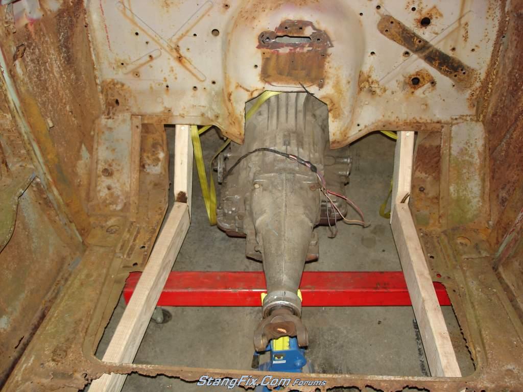

I had to make a heavy duty engine cradle to hold up the 460 & tranny combo this past weekend so I could position the engine roughly where I want it so I could drop the cab down on the frame to see how everything sits.
I think I am about there with the frame. I need to narrow the front frame section though a little. But also by doing this I am interfering with the oil filter, on the driver side - and for now also hitting the passenger side exhaust manny. I will be using custom headers, so the manifold is of no concern to me, and I figure I can run a remote oil filter if there is still a clearance issue. May have to raise or lower the engine just a tad. I'll figure it out.

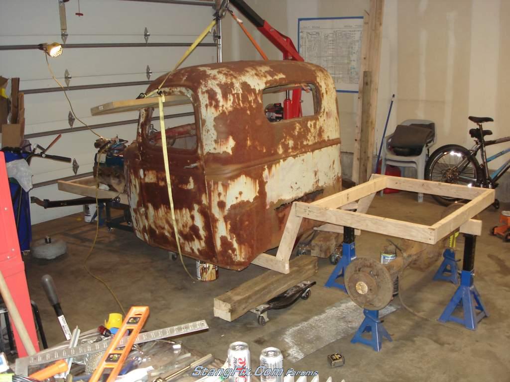

Here it is sitting almost at ride height:

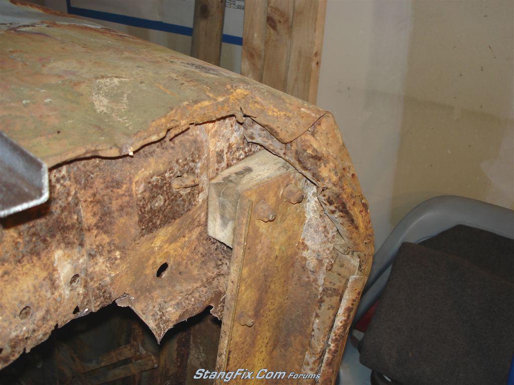

Since this last picture, I have pulled the crushed in rockers back down & out. which closes my cab to ground distance a couple more inches. Which is exactly what I want. I am going to reinforce the rockers with 2"x 2"x 3/16" angle iron -- similar to how the mustang rocker is boxed in -- for extra strength, since this will be the low point of the vehicle and may be susceptible to the occasional "interference".

Looking good. I would pull the rear end closer to the cab and shorten the wheel base even more. Run the front edge of the rear tire right at the rear of the cab. Not like you need a big truck bed, just a place for a fuel tank. At least the wood frame is easy to modify....

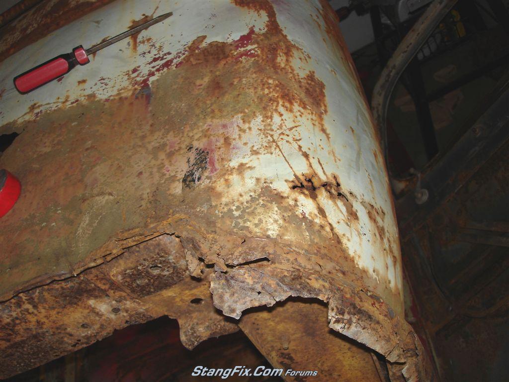

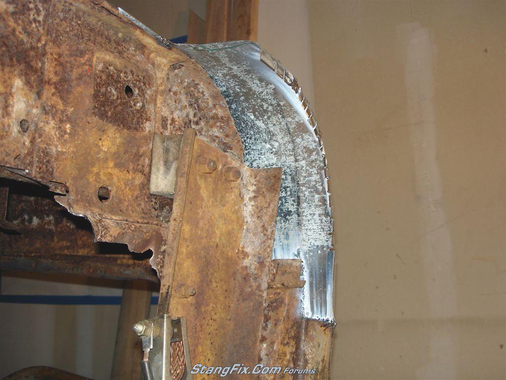

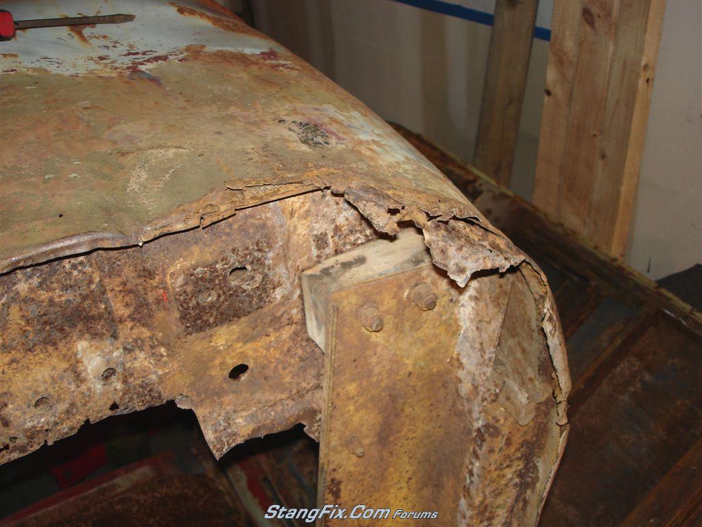

Since the weather (read SNOW) is not cooperating with me getting the cab to the blaster, I got ancy and started some rust (well, bad rust) repair this weekend too.
The passenger side cab corner had been crushed in and the rocker folder in entirely. I pulled the rocker out and straightend it. I will reinforce with angle iron as I described earlier.
I first pulled out the old cab corner to see what was there. And what was there was not much - LoL.

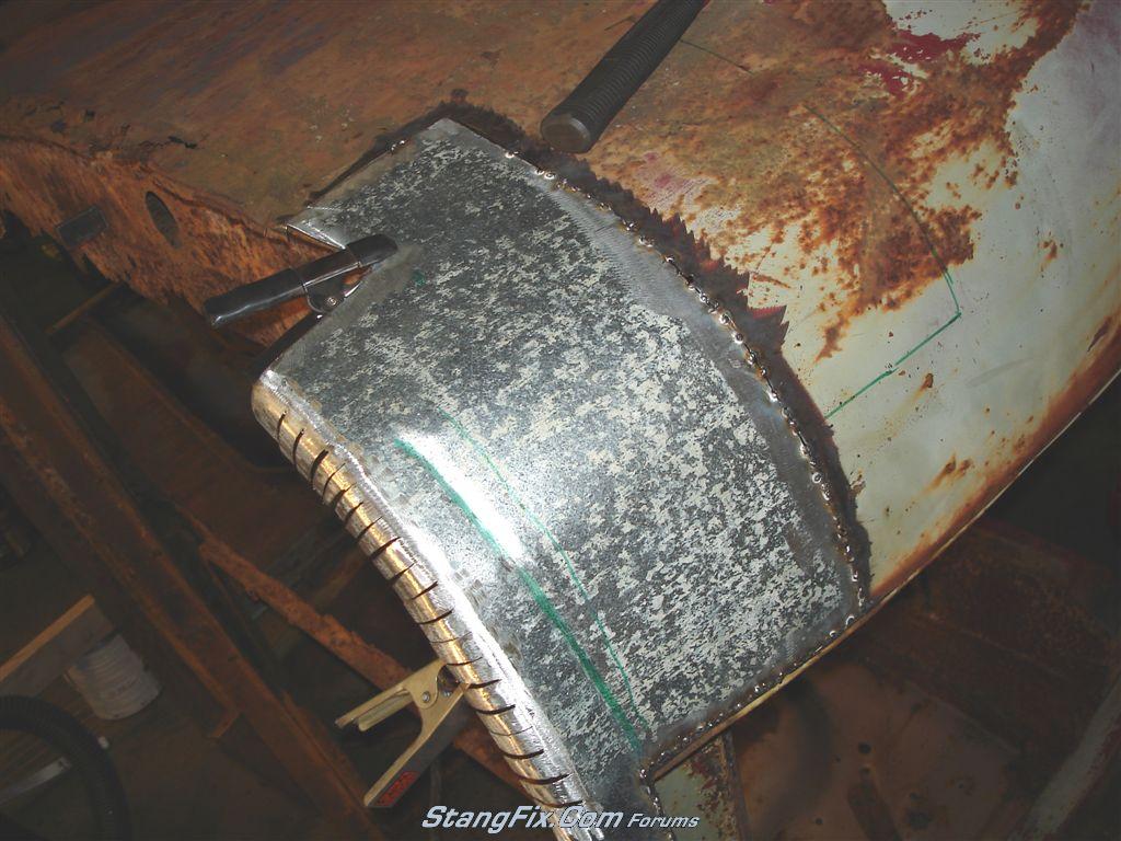

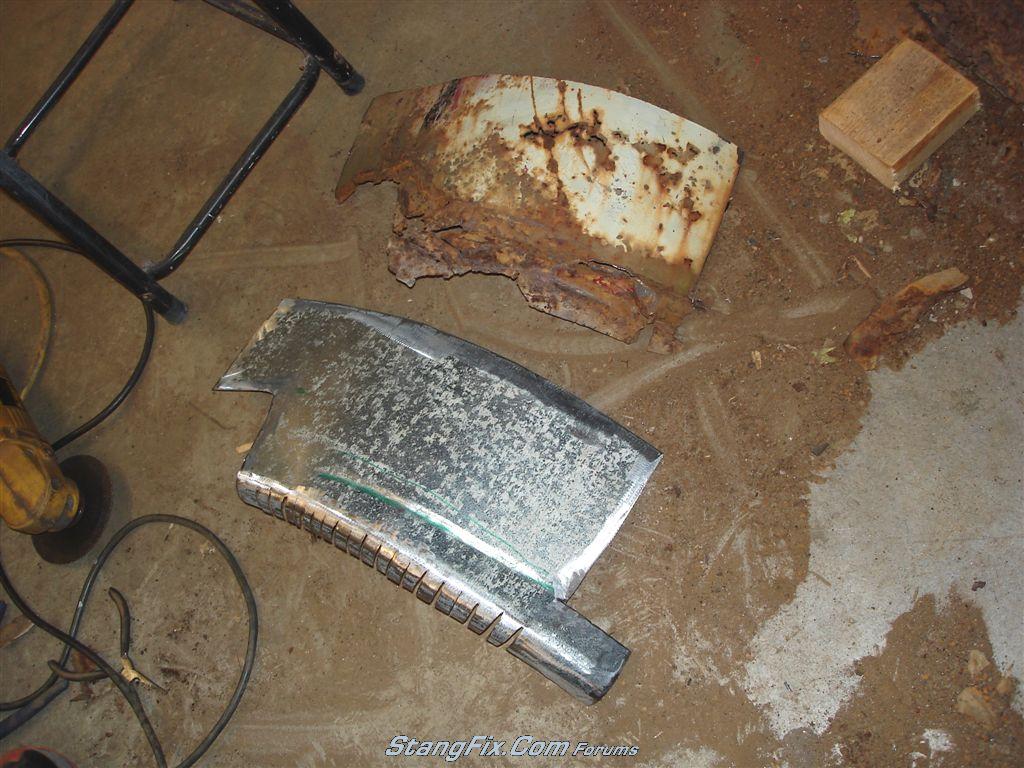

So I decided to cut out the bad shart and put in some new. Went to my supply of metal stock and started forming my patch panel. And yes, I realize it is galvanized sheet metal. All proper saftey precautions, filtered masks and air changes were inforced.
Started by rolling a bottom edge to somewhat replicate the factory look.
Pie cut it and start rough forming. And for the life of my I could not find a single pair of vice grips! I think the vice-grip gnomes stole them. So your WE clamp came in handy Rod.
Cut out the bad shart:
Old and new:

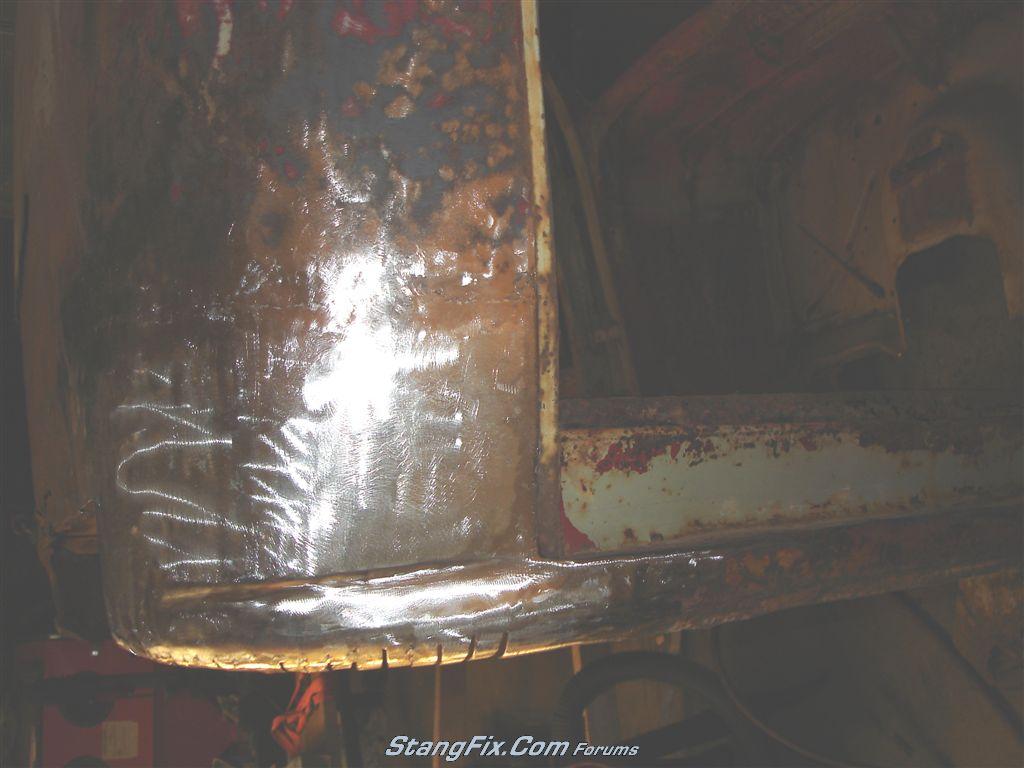

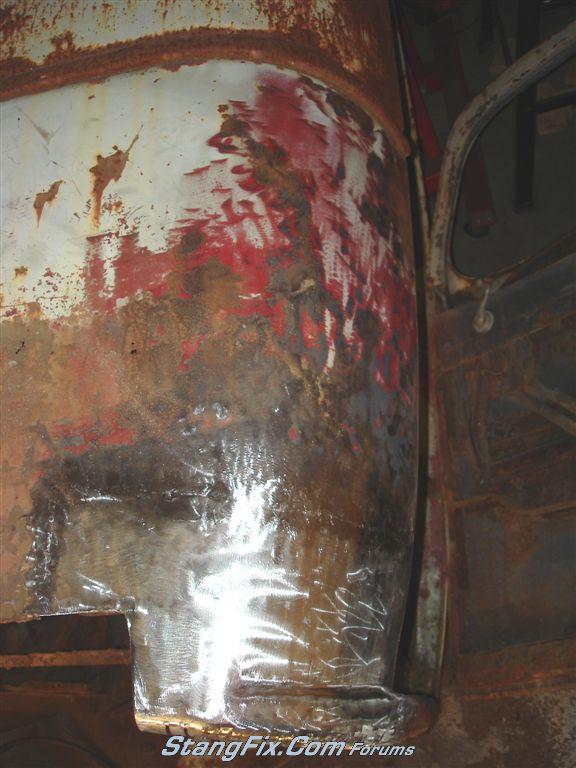

Welding it in:
The pie cuts will be welding closed when I reinforce the rocker with the 2x2 angle iron.
Now I just need to do the other cab corner and make it match. Then hit the large middle section where the big rot is.
