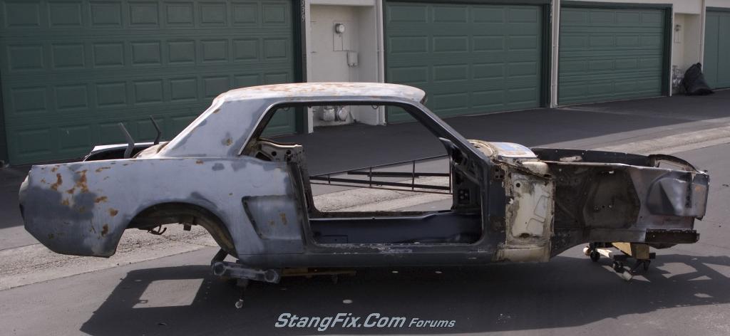

Thanks again Ryan for the nomination for project of the month, that was very unexpected. I had the day off today and wanted to test fit Fred's floor pan. It fits really good, I am really surprise.
First time since July of 2009 that Fred has been outside of the garage. It was pretty exciting to see Fred in some sunlight working on that Cali tan.
Anywho, I am pretty much finished up for the day, heading over to cmayna's shop to help with gtscode's ride for a few hours. I have monday off, so I will be coating the inside of the frame rails as well and welding in the final cross bracing so I can cut out and replace the LS rocker. Progress progress progress, I am having so much fun now that I am at this stage of Fred's restoration. I am still saving up my pennies to get Fred media blasted within the next two months. :part

Today, was Blaw. I seem to be getting sick and my body was not okay. It didn't completely stop me though. I got Fred back up on stands so Fred knows its back to business. Ran over to Lowes to pick up cut off wheels for the 4-1/2 and the 3 incher. I cut and test fit my cross bracing so I am really motivated on getting the front end wrapped up by this weekend. I will be putting in a few hours during the week in the evenings this week so I can tackle the rocker this coming Saturday.

Had a early start and early finish so I got to Fred earlier than I thought.
Worked on Fred for two hours today. Thinking about taking a break for the rest of the evening until tomorrow, still a little under the weather.
Welds started to get way better towards the end as shown on the following photograph.
Almost done with the LS, probably tomorrow evening and I will move on to wrap up the RS.
Please don't take this comment wrong, but the past picture looks like the welds are a bit "cold" and may not have welded fully into the plated structures you're trying to tie together. A perfect weld would look like you've melted the plates into the added material of the weld. You might want to turn up the voltage when welding thicker materials together.
Maybe it's only the picture and not seeing things as well as in person. Does anyone want to comment?
