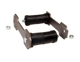

"AzPete" said:Yep....buy some stock ones. The long ones over stress the spring and flatten the arch. Those are a poor way to raise the rearend for oversized tires or a way to compensate for weak springs.
Buy these type....

"Joyr1der" said:Abe, I recommend the rear suspension kit from Mustangs Plus - I went for the 4.5 leaf mid-eye set, but they have lots of options and the kit includes everything you need (shackles, bushings, bolts etc). I think the only thing I re-used were the plates that hold the springs to the rear axle...sure you can refurb yours...it's all on my blog somewhere.
