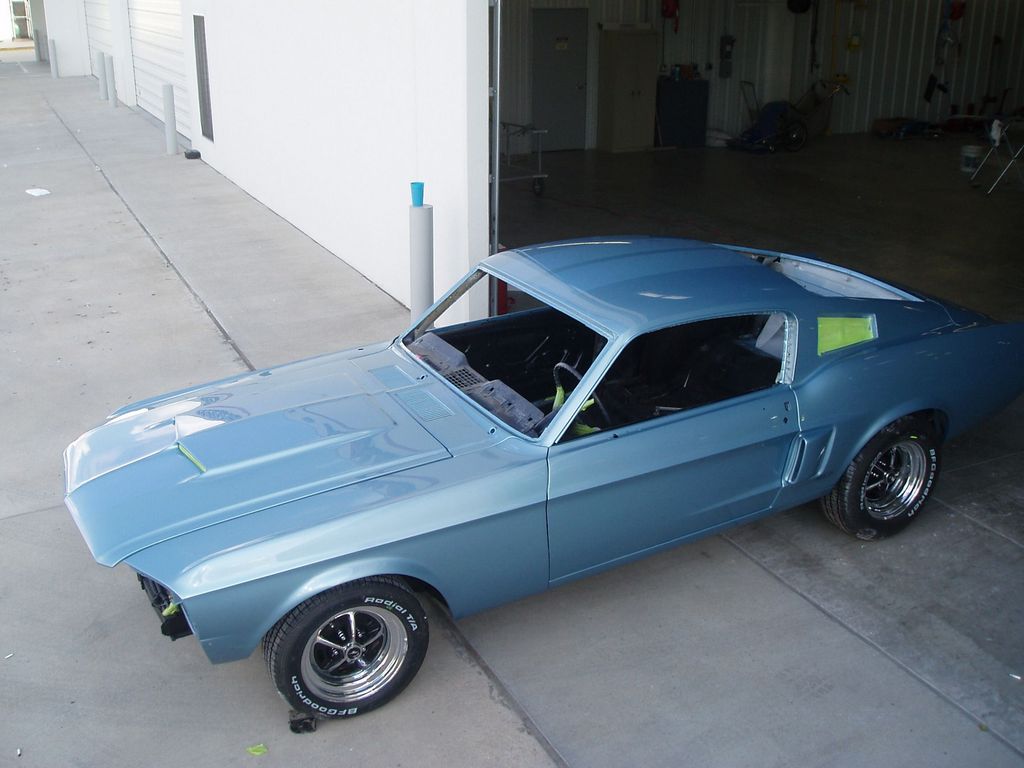

I took the back panel grill to a polisher and took a few more pics of the car while I was there at the body shop dropping it off.
I stopped by the body shop today to check up on things. It looks like just a few more things that they are going to do before we take it home. Looks like maybe it will happen next week.
I guess I should have wiped off the camera before I snapped the pictures. Some of them have spots.
That damn body shop is really dusty.

Very sharp, whats the plan for wheels and tires?
It's pretty sad but, the honest truth is I have only ever owned 1 car long enough to have to buy tires, and I have never bought a set of wheels. It took me over a year to decide on the paint color, I am hoping deciding on wheels does not take as long. A lot of people that I have talked to have suggested that they liked original 15" style steel wheels. I thought magnums, or gray torque thrusts would look pretty nice. As far as parts left to purchase wheels and tires have not been at the top of the list at the moment.

I think magnums look good on 67/68s. I know a lot of the people here like torque thrusts and other custom wheels, but I don't think magnums look out of place on any mustang.
Exhibit A:
Brittany Blue with pearl stripes and magnums.
Those do look pretty good, I have seen them on a 67 and 68 before. To me they do look similar to the Kelsey Hayes that were on the 67 Shelbys?
I think the black on the wheels would really pop with the color I had the car painted.
